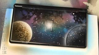

How about taking the case apart and spraying it black/blue/whatever with normal graffity/airbrush?

@Klumpen: I don't want to repaint the case because then that paint will just wear off in my pocket, and anyway I like the shade of black the case is under the paint. That's an awesome gameboy, though...
