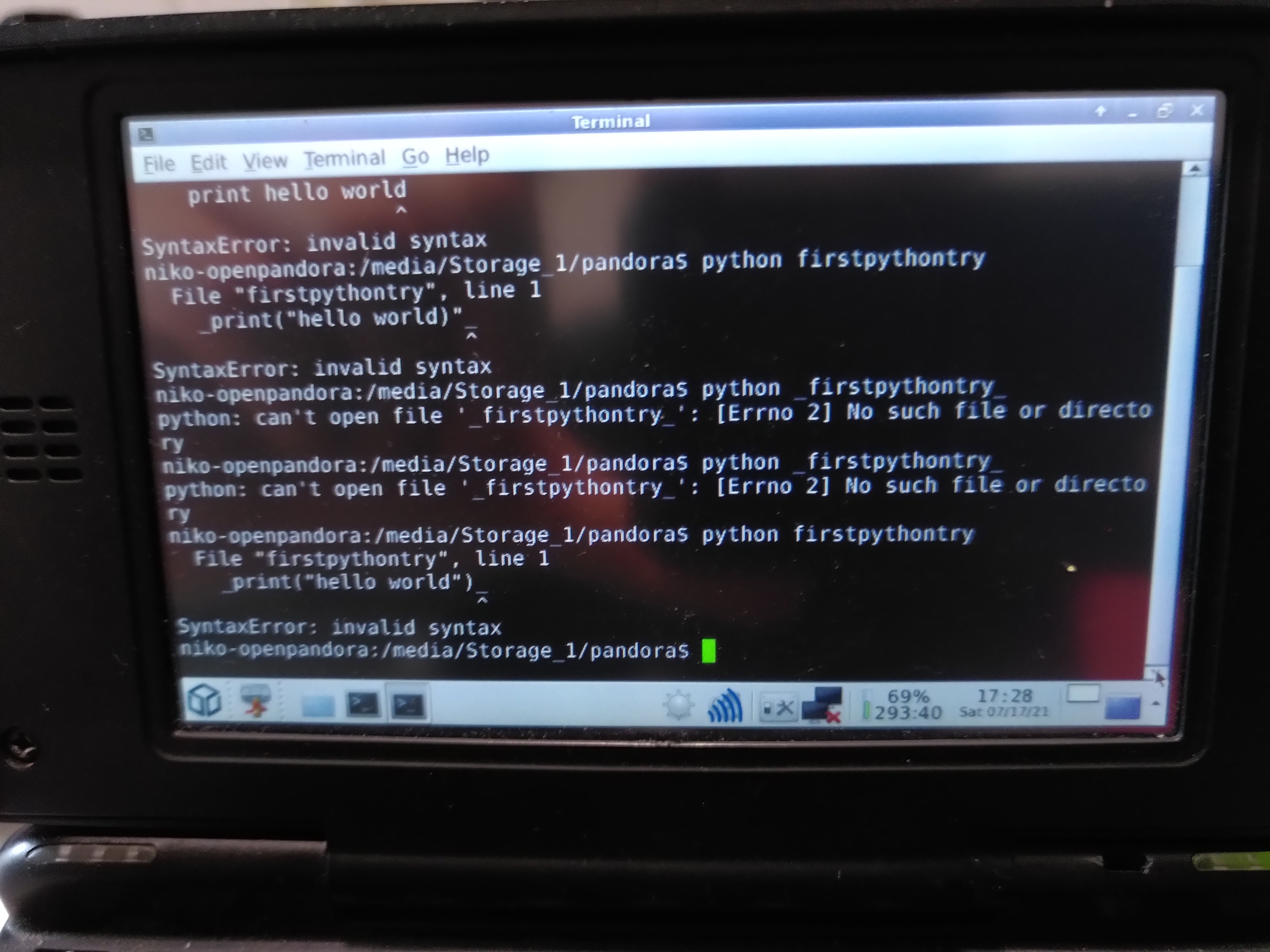

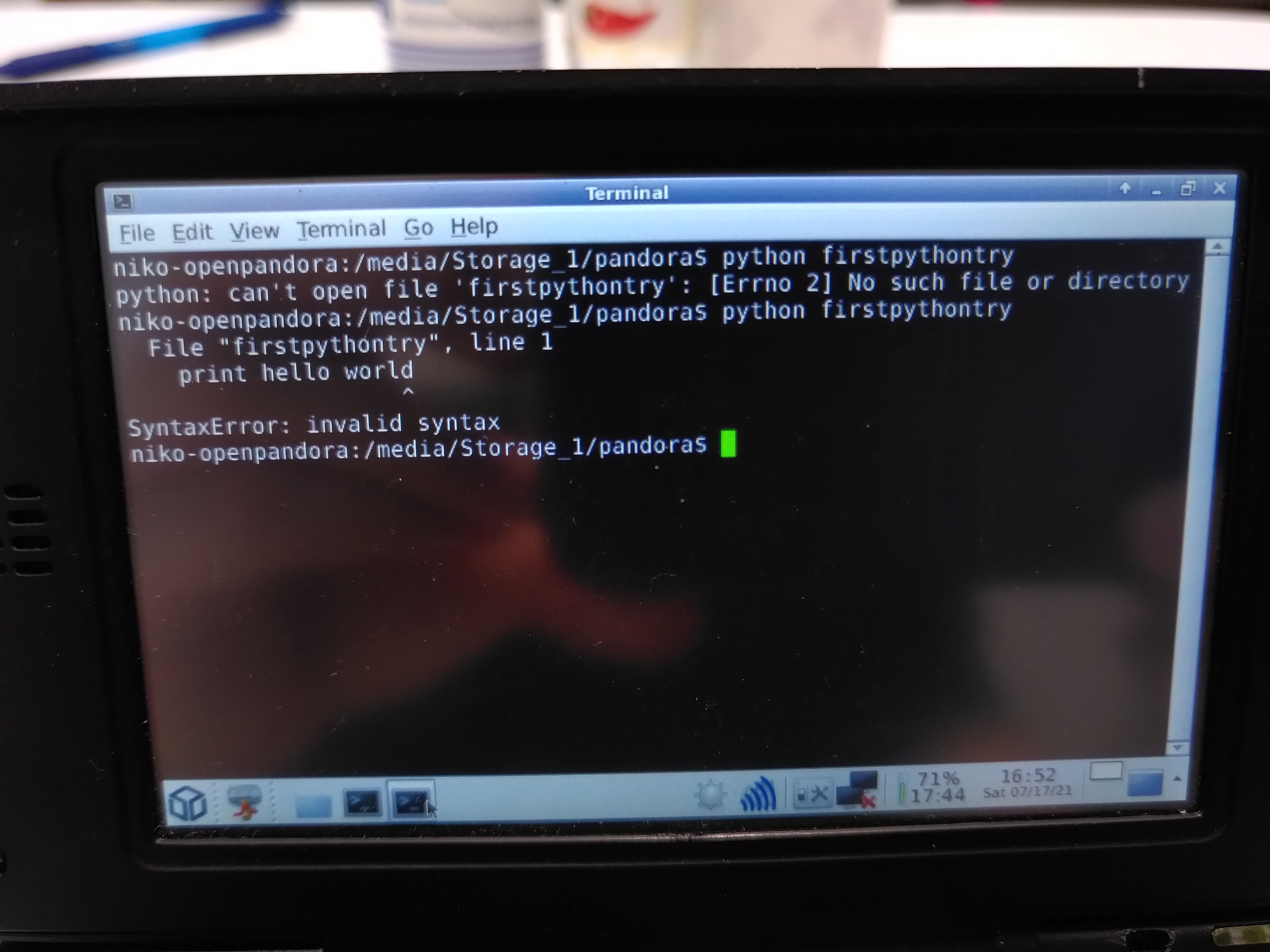

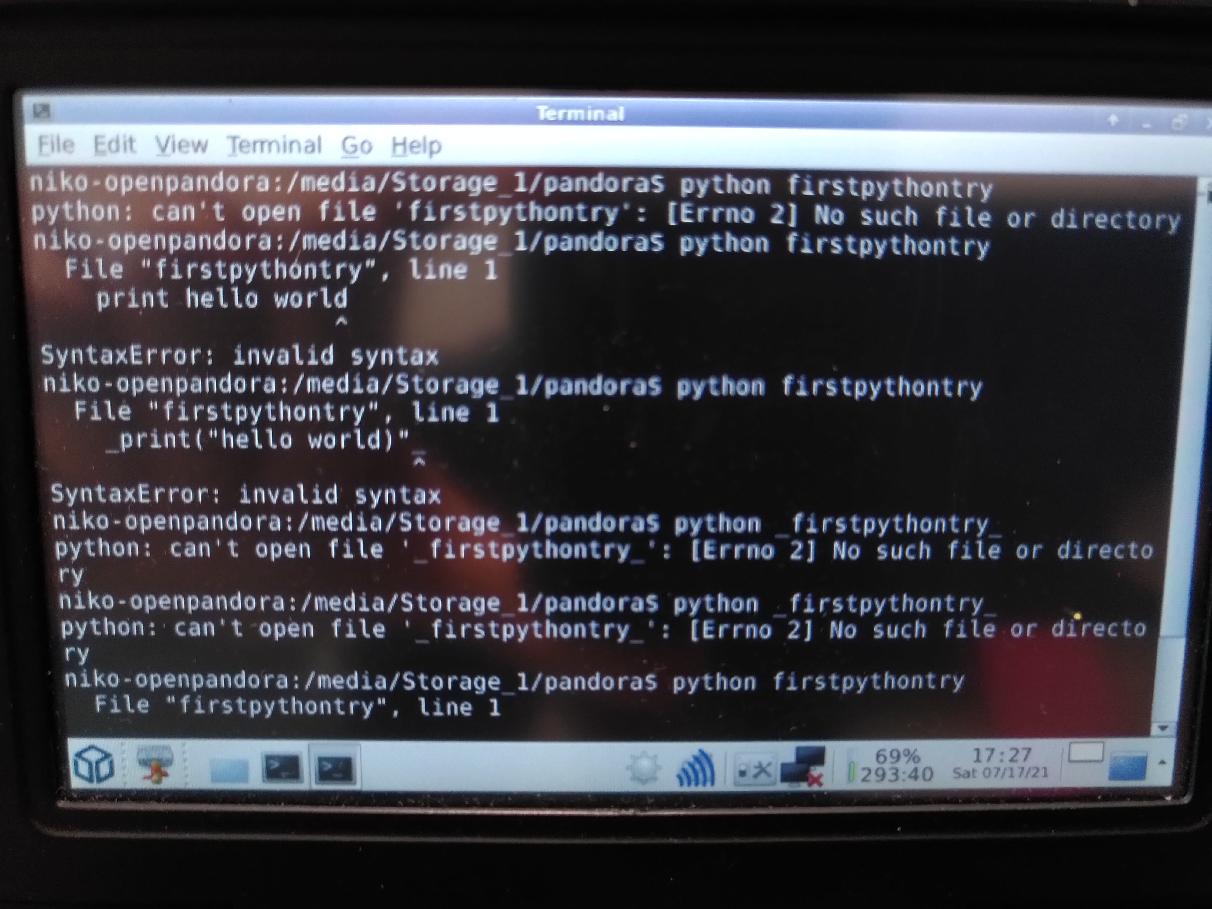

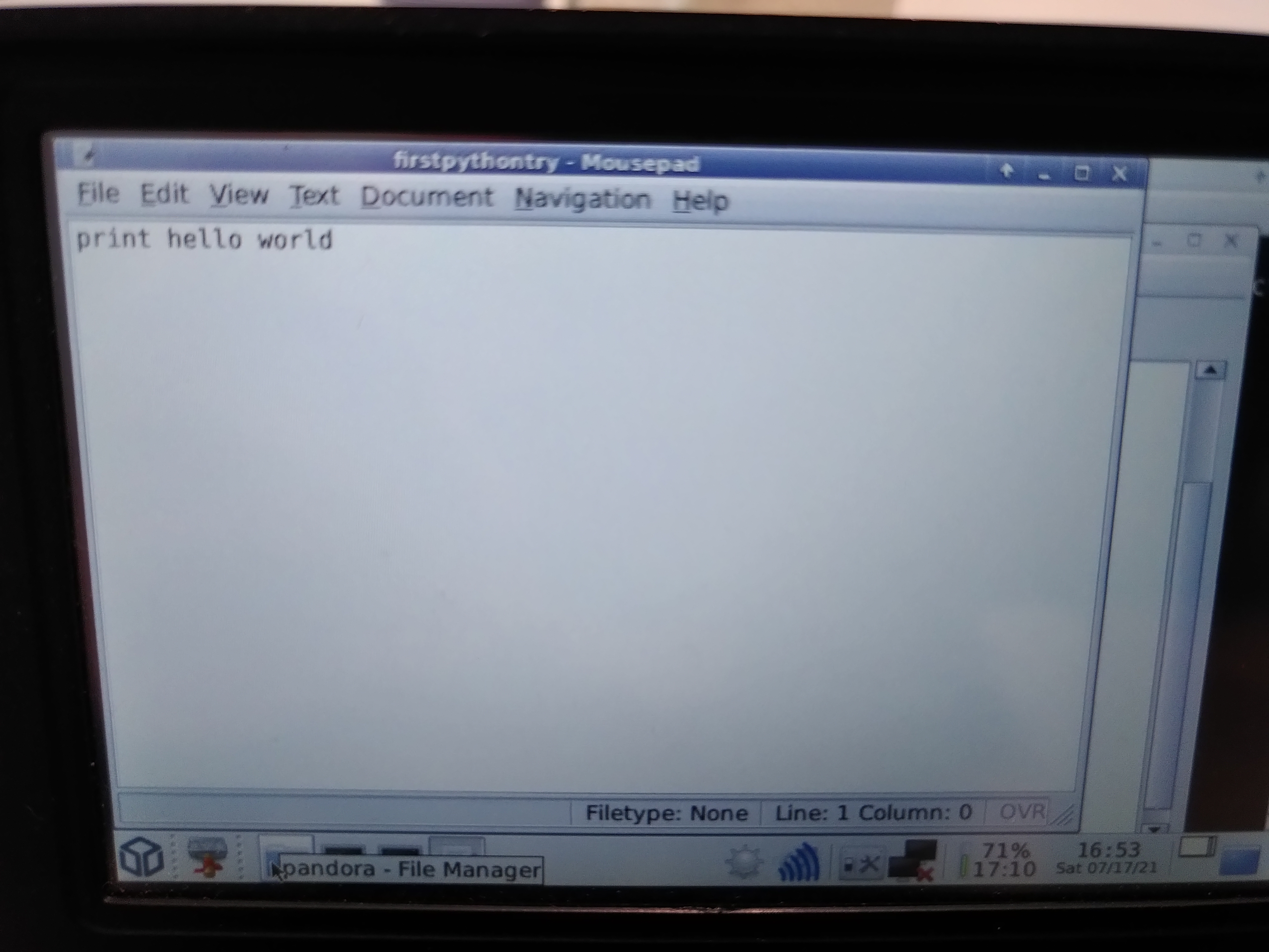

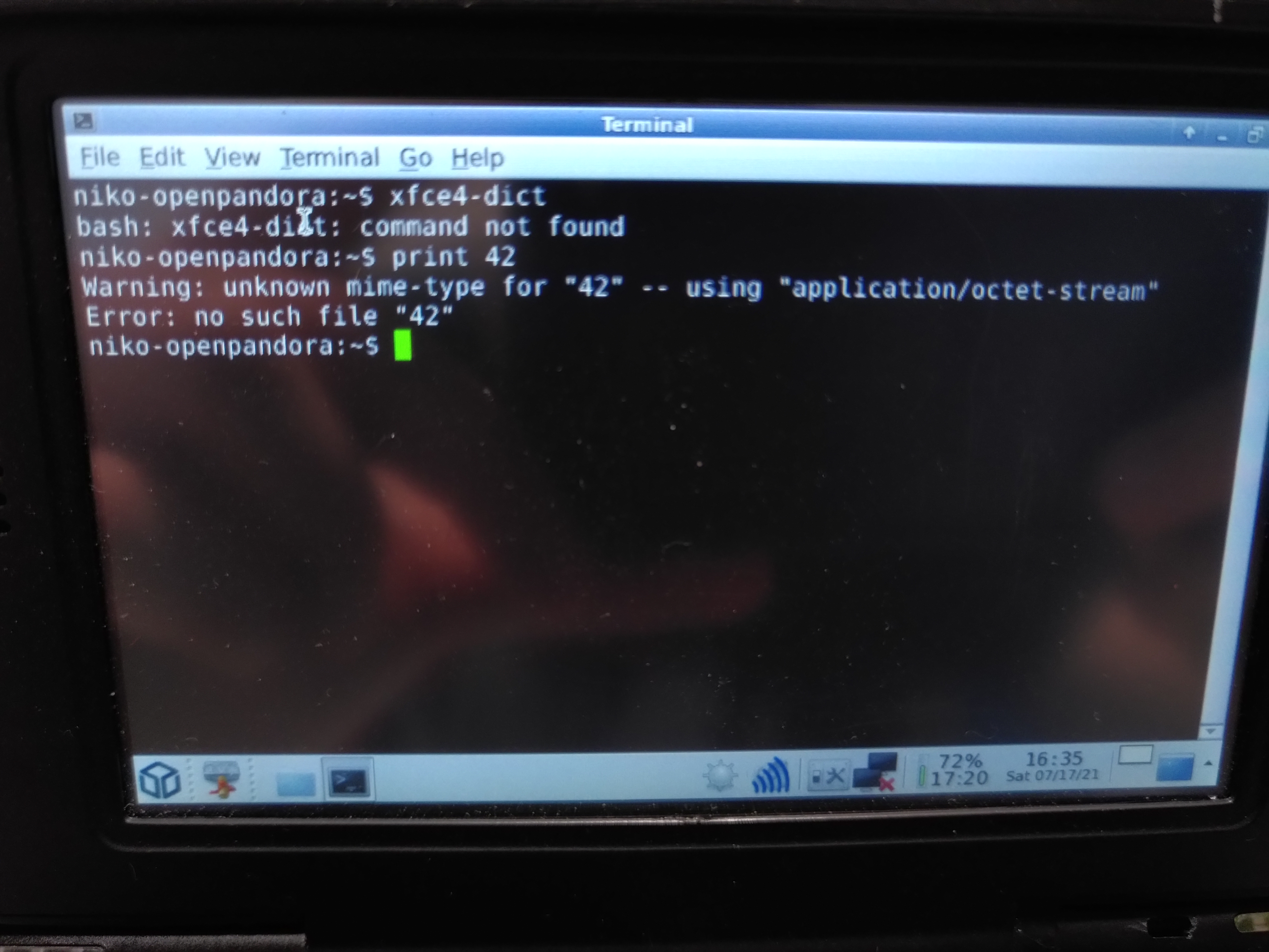

Below i attach pictures of me trying to code on pandora. I searched for my file. I opened the terminal in the directory, but pandora does'nt want to understand my writing as a console order.

Short intro:
Quotation marks are very important for code and often used.
When telling others what to write you need a way to signal what is part of the message and what is part of what belongs into the file, we cannot use quotation marks here since it is hard to read if we have a lot of them, for this reason i used _.
You are NOT supposed to copy _ too. Its:
Code:
print("hello world")
You are trying to call a function named print with the sentence "hello world".
Code works as follows: Name>action>data
The code _x=1_ expands to _something that has the name x is now identical to the data of a number 1_.
Now what you want is to call whatever has the name _print_, a call is made by parenthesis _()_ and the data is inside these, your data here is a so called string, that are letters that are NOT supposed to be interpreted by python.
A string must be in quotation marks _"hello world"_ is data, but _hello world_ are two names. These cannot interact with each other, for the interpreter its like forming sentences without verbs, thus syntax error.
I think the underscores in elw3's post were intended as emphasis, but weren't interpreted by the bbcode engine properly. Your firstpythonentry file should look like
Code:
If that doesn't work, remove the brackets. The Pandora may well be still using python 2 where the convention was to use print as a statement rather than a function.
Edit: Ninja'ed by the man himself.
Yeah I think the Pandora only has Python 2, there may be a version of Python 3 bundled with codeblocks or wxpython PND,, but not 100% though.
