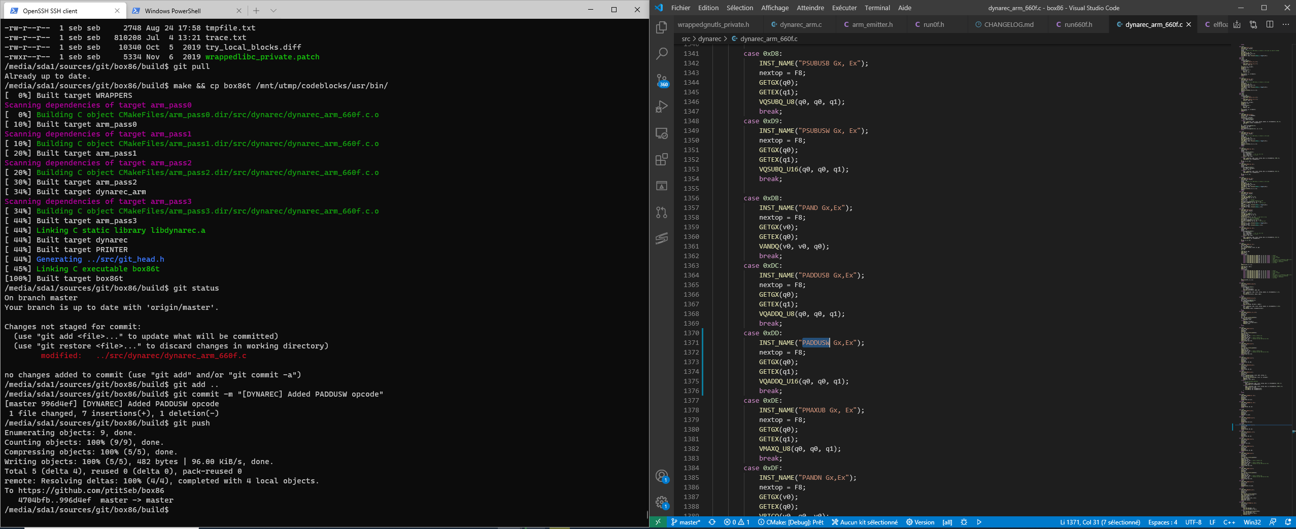

I do (mostly) all my code using codeblocks mounted, but on the SSH and SSHFS (or Samba) and with the comfort of my PC with it's ultrawide screen and VSCode as editor :)
OK, now that sounds like a much nicer solution for sure! :)
