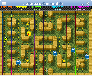

I just installed Fenix on my Ubuntu Linux desktop and extracted a ruckage gp2x game to see if it is possible to execute the game on another device then the GP2X.
GPE that starts Ruck-man:
#!/bin/sh
cd runtime
./fxi ../data/ruckman.dcb -s233
cd /usr/gp2x
exec /usr/gp2x/gp2xmenu
it seems that fxi is the fenix GP2X executable and ruckman.dcb is the game itself. Now I installed fenix but the fxi command is not recognized. Nothing that starts with fenix as well.
Running fxi from the gp2x results (no surprise) in bash: ./fxi: cannot execute binary file: Exec format error
I have installed fenix-dev, fenix-plugins:386 and fenix-plugins-mpeg:386 - no other fenix packages is available in the repo.
Then installed http://manpages.ubuntu.com/manpages/xenial/en/man1/fenix-fxi.1.html and after that
fenix-fxi ruckman.dcb results in'ruckman.dcb': file does not exist or it's not a DCB version 6 file or compatible
Ubuntu fenix-fxi version is 0.92 and I think ruckage used 0.8 so could be incompatible. I haven't found a 0.8 deb yet or source that can be compiled.
http://fenix.divsite.net/ doesn't really help..
I have seen a comment of someone that managed to execute a ruckage game on his Linux PC so I hope it is possible. Any suggestions?

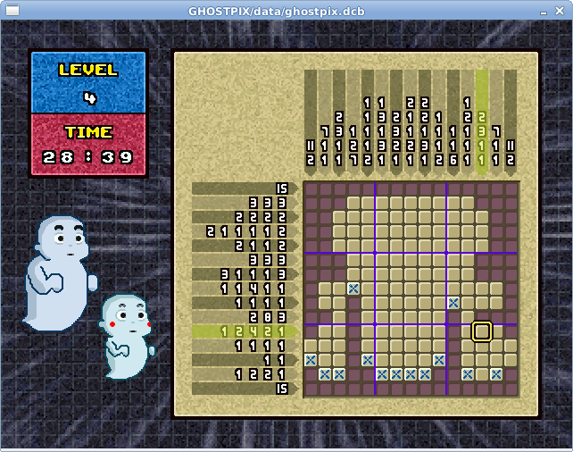

Small update:
- I have fixed the graphics errors
- Implemented input remapping via config file
- Activated scale2x
- The games no longer have control of some screen options
Tried some more games: Protozoa, GPNoid, Ghost Pix work

It is already working very nicely, thanks :)
A game like snake on dope that needs accurate input has no problems at all and seems to respond just like the gp2x (only played for a few minutes). No graphical glitches or problems with sound.
I couldn't start ruck-man though, enter key isn't accepted to start the game. Pushed all keys on the keyboard. Also created a fxi-2x84.conf but that didn't help.
It does exit when I press enter combined with space and in other Ruckage games it works fine as well (usually pauses the game)

Ruck-Man should definitely work. It should react to the "B" button, so the "D" key in your config (left "Alt" key by default).
Meanwhile, I have been experimenting with OpenGL-based scaling, and it is running smoothly. With --scale2x, my (admittedly slow) laptop was struggling to even make the 30FPS cap set by Ruck-Man (33ms/frame). Scale2x and SDL_UpdateRect (which puts the pixels onto the screen) took about 15ms each.
Doing the scaling/conversion/blitting via OpenGL is much faster. There are still issues with alpha blending though, for example in Ghost Pix (the yellow highlights visible in my screenshot above are rendered as solid black).
Yes, you're right. The d key was working. Not sure why it didn't work the first time I tried, maybe caps lock.. oh well..
On my main system ruck-man is working brilliantly with scale2x but that system is pretty fast.
