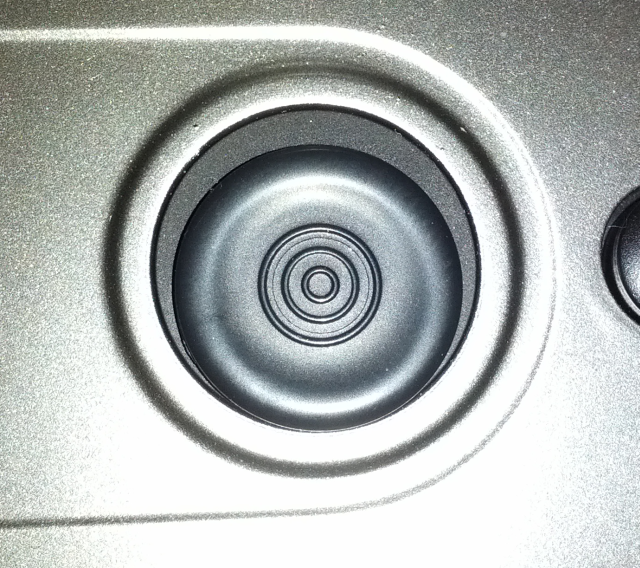

Mine is acting exactly the same. I have had mine for about 2 weeks now and it has gotten slightly better but it is still not usable. I've tried everything I could find. I flashed SuperZaxxon 1.51, I used compressed air to blow into the gap between the nub and case. I reboot all the time because I don't leave it running. I have been sitting there just moving both nubs constantly while watching TV for at least 30 minutes each day. I have actually found that mine doesn't center itself properly. I can move it to one direction and it will stay pretty close to where I moved it. Here is what mine looks like.
The above picture doesn't prove it's not centering properly.. Mine will rest what looks like not center but actually works fine..

Confirm erratic behaviour with the right nub on my Pandora(1ghz). Nub feels loose (compared to left nub) and doesn't allways return to center (see photo post #4). When Pandora has booted to GUI calibration seems to start and within one minute both nubs act normal (ie. trigger contextmenu <on> with RMB and <off> with LMB). Several minutes later however it feels like all functions shift to another position within the right nub and suddenly they are difficult to trigger (ie. contextmenu flashes on and off screen). Probable causse discussed in thread, maybe fixed in next firmware?
