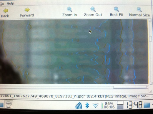

I've noticed randomly that blue would be offset from the rest of the screen at times. When this does occur and blue is shifting (1 pixel?) to the right.
At first I thought it was the screen changing to lower color depth for some reason, but who knows. Maybe an app is causing issues when I go back to desktop.
Rebooting doesn't fix it. Cursor seems a bit yellow.
I've seen it go away, but don't know why it happens in the first place.

Yes, very strange how that works. Seems to affect a very specific range of brightness on mine too. It's like when I zoom in on a picture the contours of these lines actually change like google maps or something. VERY VERY WEIRD.

Messing around with the hinge or bezel does nothing. I can't reproduce the issue, it only happens randomly. Apparently I can make it go away though! I just plug in the AC Adapter and apply a gentle caress to the head of the plug. Don't know why that works. Could be pressure on the board, broken soldering, or some kind of interference. I really don't know, but this seems to fix it for me.
Next time you get it, you could give that a try.
