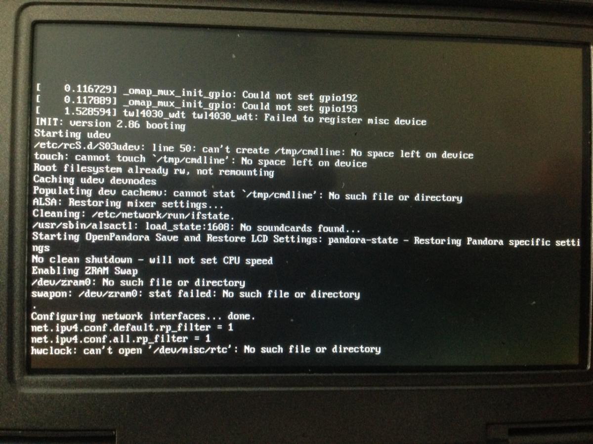

My Pandora won't boot!
The Booting Kernal 3.2 page appears and gets within about a centimetre away from completing the loading bar before freezing. Eventually an error message appears. First time this happened, i was aware that i hadn't used it for a while and plugged in the charger. Eventually the red light came on and the machine booted up okay.
Now it's gone back to stopping on the kernal boot screen again.
Does anyone know what i can do about this? I've included the error page on an attached jpg.
I would be very grateful for any advice you can give me.
Cheers!
Those file errors suggest you've filled up the drive with the OS on - probably the in-build NAND if you're not booting from SD.  If you want to add things to your OS, I'd suggest booting from SD, but otherwise I'd suggest not filling your NAND with cruft, and instead putting than on SD cards.
If you want to recover any of the stuff you've put on the NAND you'll need to learn how to boot from SD and mount the NAND and then copy stuff off.
Other than that, I'd suggest you reflash your unit; it's not hard (especially in comparison to creating a bootable SD card by hand).

So something you should know, the internal memory that stores the OS only has 512MB and almost all of it is used by the OS itself. You have to be careful if you install anything to the internal memory as there is at most 100MBs of free space. Instead store things on the SD card memory.
So Wow that link is over 5 years old...
The Pandorawiki has a bit of information, but a bit convoluted for new users and someone really should revisit that page...
The latest firmware release is 1.72: http://boards.openpandora.org/topic/18363-superzaxxon-v172-released//URL]
Follow the instructions on the bottom of the first post labeled: "Upgrade instructions using the Full-Flash-Image" and that should get you going again.
If all you did was put some PNDs on your SD card, your NAND really ought not to be filling up.  Something doesn't add up; either you did add stuff to your nand by accident, or your nand is not actually full.
That said, reflashing will bring the system back to factory settings, so should sort out any software problems, but you might lose anything you'd accidentally saved to SD.  If it's only PNDs you can always redownload those though.
Also, last time I checked, the instructions included with a release zip tell you everything you need to know about reflashing your unit, and are more up-to-date than what's on the wiki, so I'd suggest you just download that and do what it says in there.
