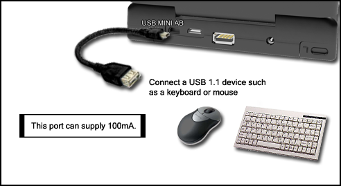

What does “OTG” mean?
OTG stands for On The Go. USB OTG ports can operate in two different modes. When connected through this port, the Pandora can act as a device, for example when connected to a computer for charging & data transfer. For this mode, you need a standard-A to mini-B cable. However, the Pandora can also act as a host port for USB 1.1 and USB 2.0 devices. For details on how to make the necessary cable connection, see the OTG host mode section. This port can supply a maximum of 100mA in host mode. Although this port implements On The Go functionality, it can not get an official On The Go certification because the OTG specification requires a device to have exactly one USB port. (The Pandora has two.) Also, the mini-AB connector used on the Pandora has been taken out of the specification in 2007 (but is still widely adopted).
OTG host mode
Pandora in OTG host mode
How you connect a device to the mini-AB OTG port depends on the device's USB connector.
* standard-B receptacle: Use a mini-A to standard-B cable.
* mini-B receptacle: Use a mini-A to mini-B cable.
* micro-B receptacle: Use a mini-A plug to standard-A receptacle adapter and a standard-A to micro-B cable.
* standard-A plug: Use a mini-A plug to standard-A receptacle adapter.
* mini-A plug: No extra cable or adapter needed.
* micro-A plug: No standardized solution exists.
This port allows you to connect a USB 1.1 device directly, without the use of a hub. This port is also USB 2.0 compliant.
Notes:
* mini-A and mini-AB connectors have been removed from the present USB standard. This means that the above connectors may vanish from the market at some point (although there will probably be demand for them for some time). There are a lot of connectors available that were never standardized. It is recommended that you do not use them as they may lead to non-working connections. Stick to the cables and adapters mentioned above and look for a mention of "OTG" or "On The Go" and you should be on the safe side.
* In host mode, this port can supply a maximum of 100mA. USB 1.1 devices that draw more than 100mA will need to connect to Pandora's other USB port via a hub, as depicted in the previous example. The Huawei E220 is one such device.
