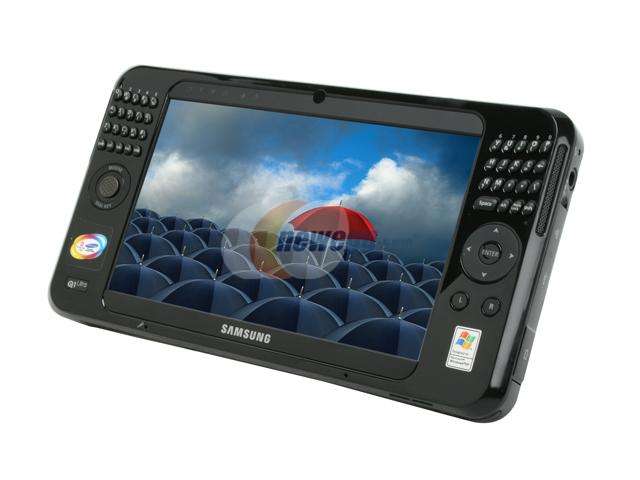

OP can buy an Atom based gaming machine as soon as someone makes one. OP need no longer try to convince everyone here that Pandora should be that device. I think this thread does a fine job of showing the community's support for the direction that the Pandora is headed in right now. For the people, by the people!
http://www.newegg.com/Product/Product.aspx...N82E16834131028
I think that is what you want. Problem solved!
'palmertech' said:
...Samsung stuff removed in quote...
Guess again. :p
