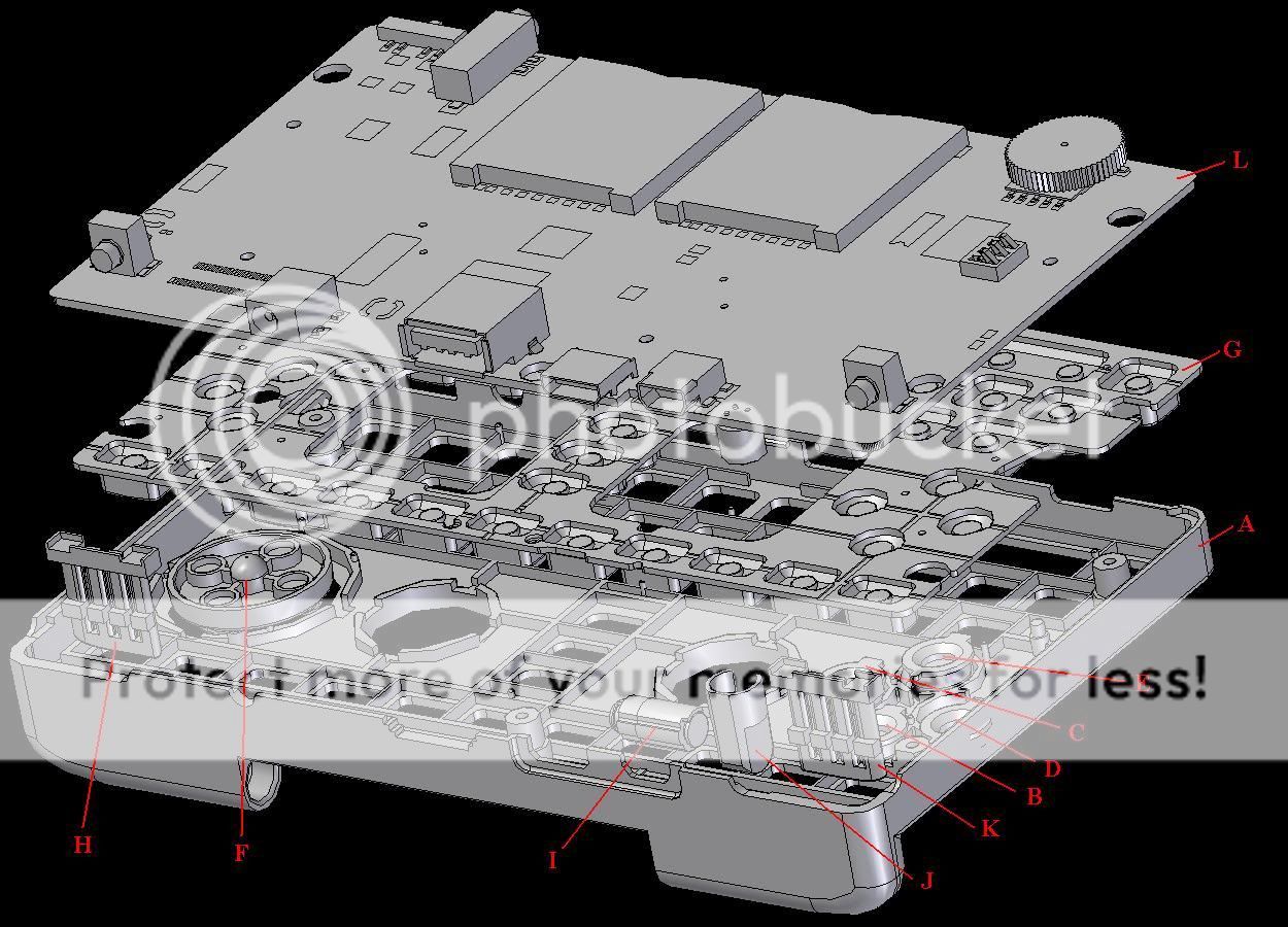

Big render of Pandora Base Parts:
Big render of Pandora Lid Parts:
Thanks again!!!
