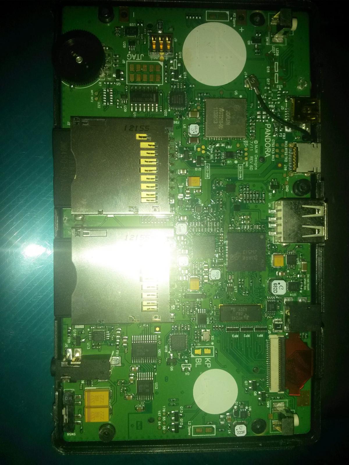

The coil's on the underside of the board (there's not much on the keyboard side in comparison) so it should be rattling around there still once you remove the bottom of the shell. It's a small-ish cube (4mm across) with a white sticker on the top bearing the part code, located directly below the top right (as you view it) screw support hole, to the top right of the white paint circle marking the underside of the d-pad.
I took a picture of it a few months ago..
Marked as 682D. Picture Here:
That's not the one that usually comes off - it's the one on the far right edge of the PCB, down and right from the LCD connector.
I'll take another look tonight, but I didn't see anything rattling around... I'm hoping it's connected and loose in this case otherwise... it's something else at fault. :(
Thanks for the support, as per usual! ;)
OK I opened her back up and I don't see anything loose. I've attached a photo of the board just in case an eagle eye can spot anything but it looks like I'll have to prepare the Pandy for a trip to Germany...
Check if 223F part (bottom of the pic) isn't a bit loose, it looks positioned slightly wrongly. If it is it shouldn't be hard to find someone to resolder it for you, or at least some local electronics/mobile phone repair place that would be able to help with that.
Yep. As long as it hasn't fallen off, putting some solder on both sides where it's soldered and PUSHING down the coil onto the fluid solder until it is hardened should do the trick.
