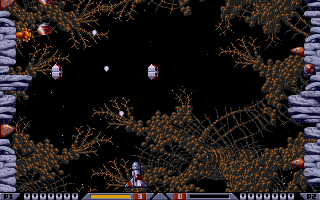

Xenon 2: Megablast:
thanks  skeezix ;)
i will try it soo
EDIT: tried now, very good! run nicely and speedy, but if you can add the touchscreen support ;)
i have to test it more, but it looks very good jet
