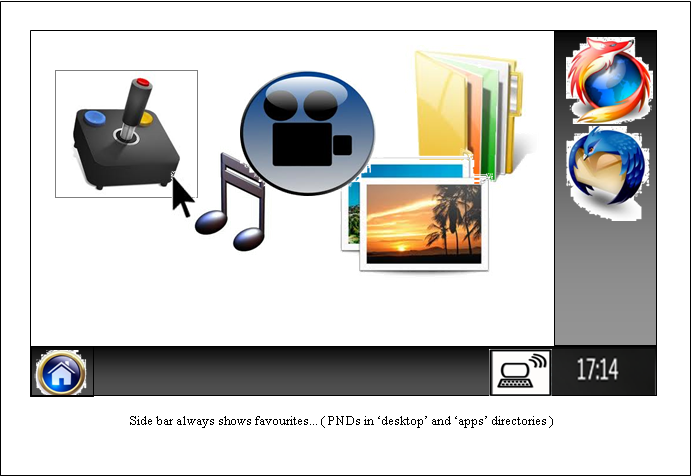

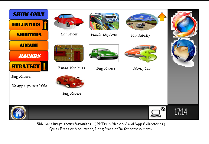

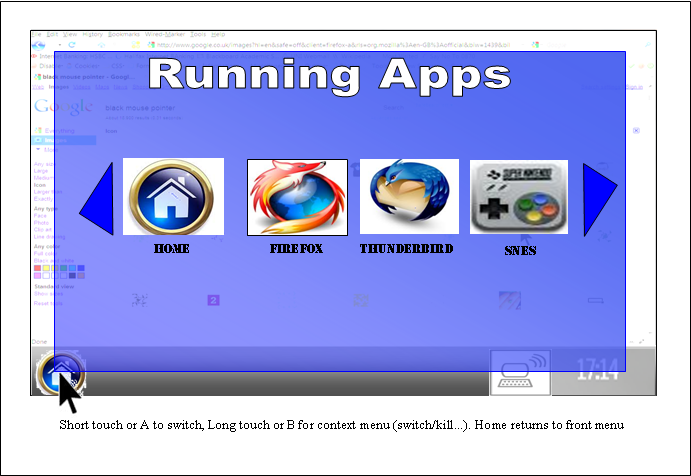

Well now I'm apparently less than 24 hours away from being back in Pandora land I thought it was time enough for me to get a little more active on the forum. And with that in mind, I'd like to introduce my concept GUI. While I don't actually have the coding ability to make it happen, I actually think this concept is entirely possible with minimal effort by bolting together various things that are already in use on people's 'doras.
First some screen shots, then some conceptial how-dos.
Now, any good GUI should be self explanitory, and I hope my concept is. But I'm sure I haven't thought of everything so please ask quetions and, of course, give any feedback (possitive or negative) as to what you think.

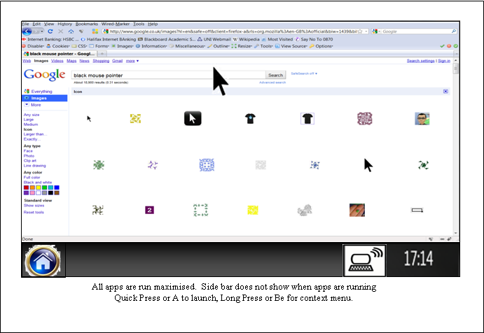

Well, firstly we need a full screen, always maximised window manager. I'm not going to do the search right now, but people have already got minimenu working with Matchbox Window manager.
Secondly, a panel is needed. There are plenty of these around.
Finally a launcher is needed. The 'home' icon doesn't link to any integrated menu system. The 'home' is basically an external application that is loaded on startup. It is a basic launcher... when the 'games' option is selected it could lauch an appropriately skinned, more sophisticated menu, such a slightly modified minimenu to only look in the 'games' category.
The audio, music and documents could start off linking to either a file browser or a an appropriate application. Perhaps eventually dedicated interfaces could be created.

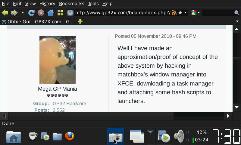

Well I have made an approximation/proof of concept of the above system by hacking in matchbox's window manager into XFCE, downloading a task manager and attaching some bash scripts to launchers.
becomes:
nothing much here.... the icons on the desktop would ideally be in a side bar which would be carried over to the next page

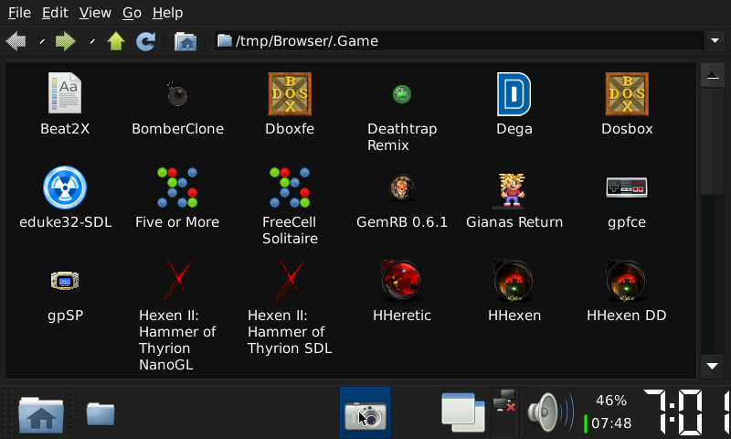

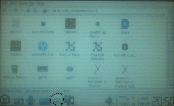

So I've written a little bash script called showcat which searches for all PNDs with a specified category, makes links to them in a temporary directory, then opens thunar in that directory. The circled icon calls "showcat Game", the one next to it, "showcat AudioVideo". No filters or sidebars yet.
making apss full screen was a bit problematic. Right now I can't get XFCE to start up with matchbox window manager by default, I have to kill xfwm4 and force the loading of matchbox before xfwm4 manages to reload itself.

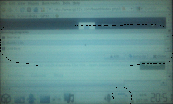

The weakest link, tasks management. I doubt I'll be able to improve the situation myself. Once you kill xfce's built in window manager its little built in task manager stops working. So I downloaded the only other task manager I could find: gpe-taskmanager . There's no documentation about this that I can find so I don't know if it's in any way configurable... right now it only shows three lines, making you scroll unnecessarily and isn't laid out in the nicest fashion. You also need to select an item, press 'switch to' or 'kill' and then subsequently press 'close' to close the task manager. Clunky, but it just about works.

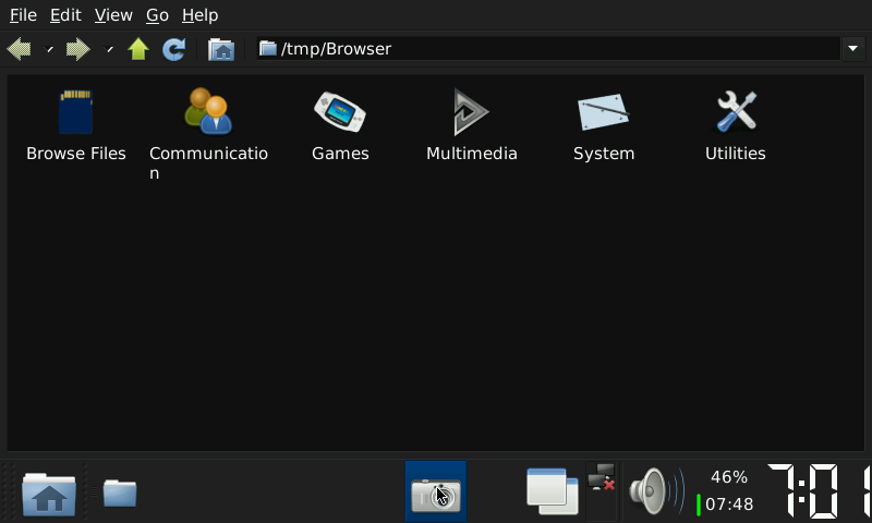

OK So I've had much better progress. I am now running without a desktop; just the XFCE panel combined with matchbox window manager and thunar as the built in browser.
Home. The Categories are .desktops which are stored on the NAND and copied to /tmp on session start. Creating the category links is the only real 'manual' part once the system is installed.
Browsing categories - works nicely enough (see issues, below). Still no Side Bar or filters, though.

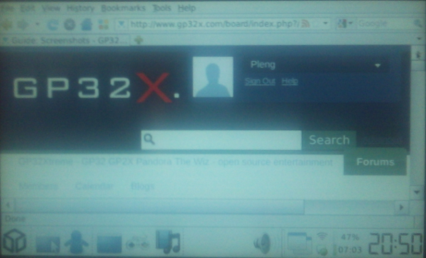

Browsing the web with firefox

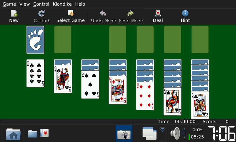

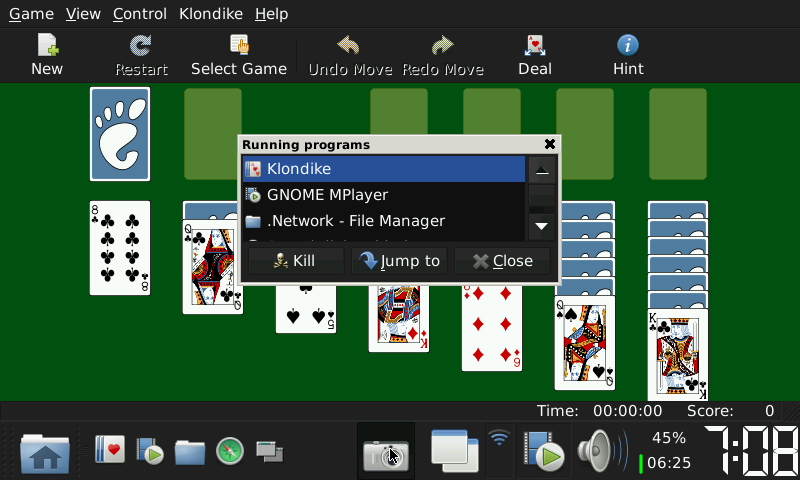

Playing a game of cards
And again the not very good task manager. It's not quite so vital now, as by removing the now redundant start menu and launchers we've created a lot more space in the icon box... it should hold more than enough icons for every day use.

The system works very nicely to be honest, aside from the task manager there is only one real issue: Thunar! It's being made to do a job it really isn't supposed to. There's no command line tools to feed Thunar a new directory to jump to. So the home icon and all the categories send thunar a message to quit (one of the few command line options it supports) and starts up a new instance. At the standard clock speed this takes a little too long but with a bit of overclocking it's ok.... but yea, you don't really wanna overclock just to run your default environment.
Also there's no way to remove the menu bar and toolbar. And, of course, adding filters and a quick launch bar to the side is impossible.
And I've removed the side bar. Which is great for this purpose. But thunar is also used to access the content of your home directory by clicking on 'browse files' on home screen. And it means there are no links to your SD cards etc...
I think ideally, short of making a custom launcher interface, I might try and find another, more customizable file browser - use that for the interface and leave thunar untouched. But it's all a matter of time...
