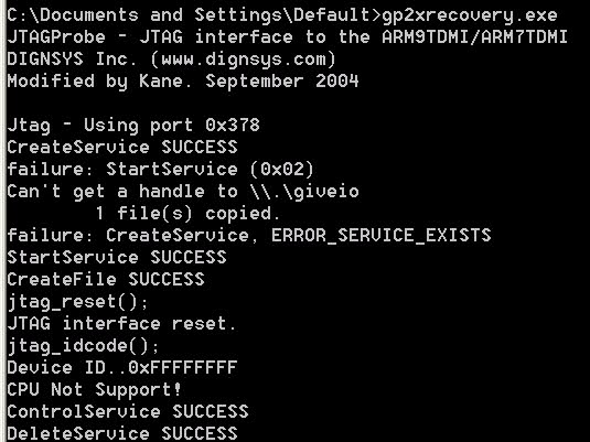

checked the cables, power. everything seems fine. any other ideas? here's the exact output
Hi.
Looking at the screen I would suggest giveio is not installed correctly or you are using Vista !

There's nothing wrong with your giveio, otherwise you would get an error message such as "Couldn't access giveio device".
I'd therefore still say you need to recheck your cabling - perhaps the parallel cable you have doesn't have all the pins connected?
