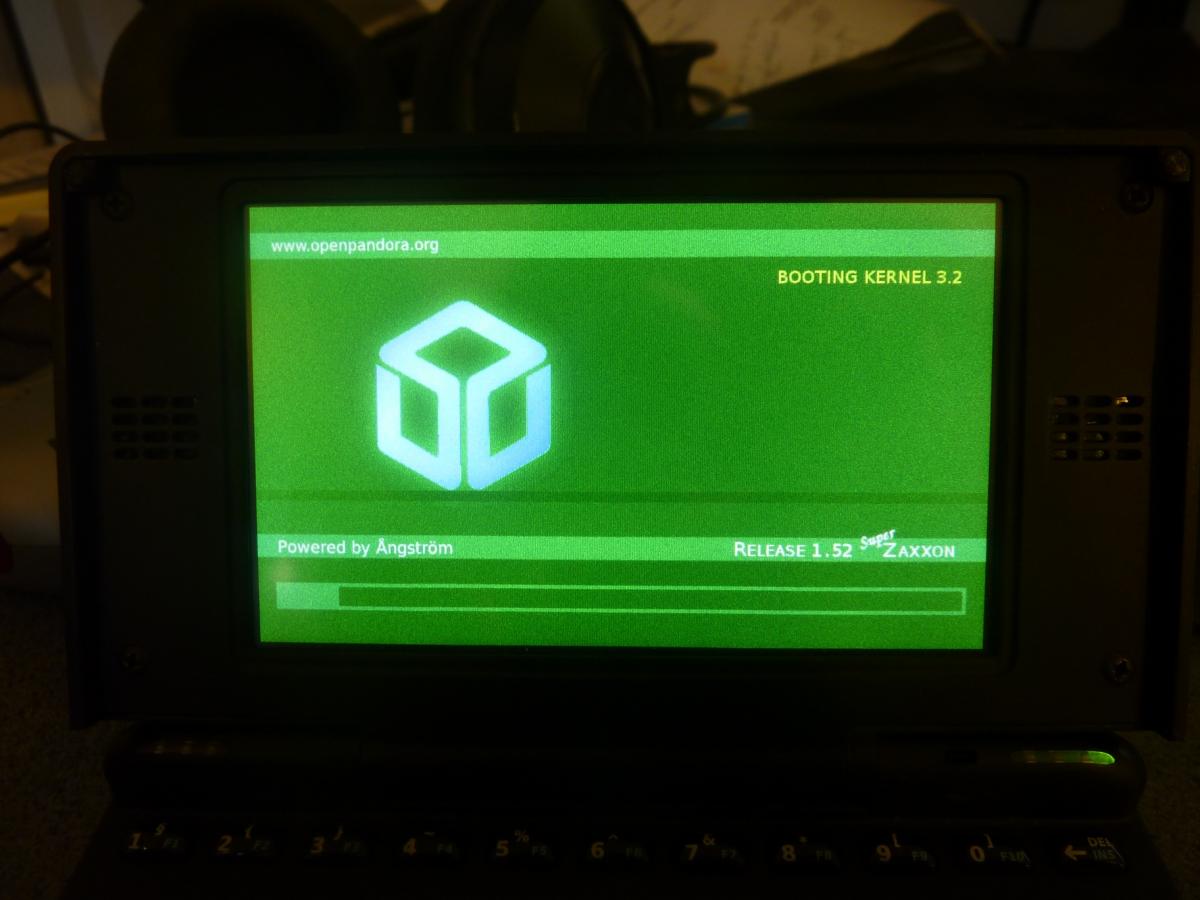

At boot, there is green tint all over the screen :  P1020545.JPG

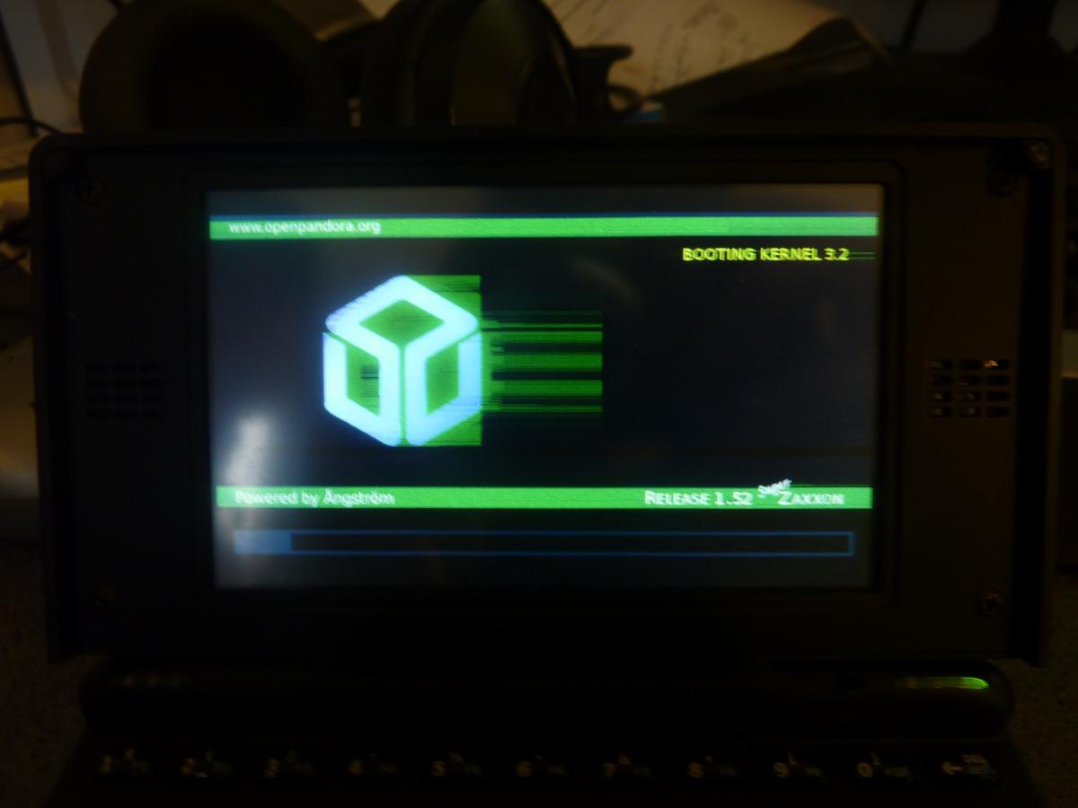

That green "mask" removed itself during boot sequence, by some strange line pattern: P1020546.JPG

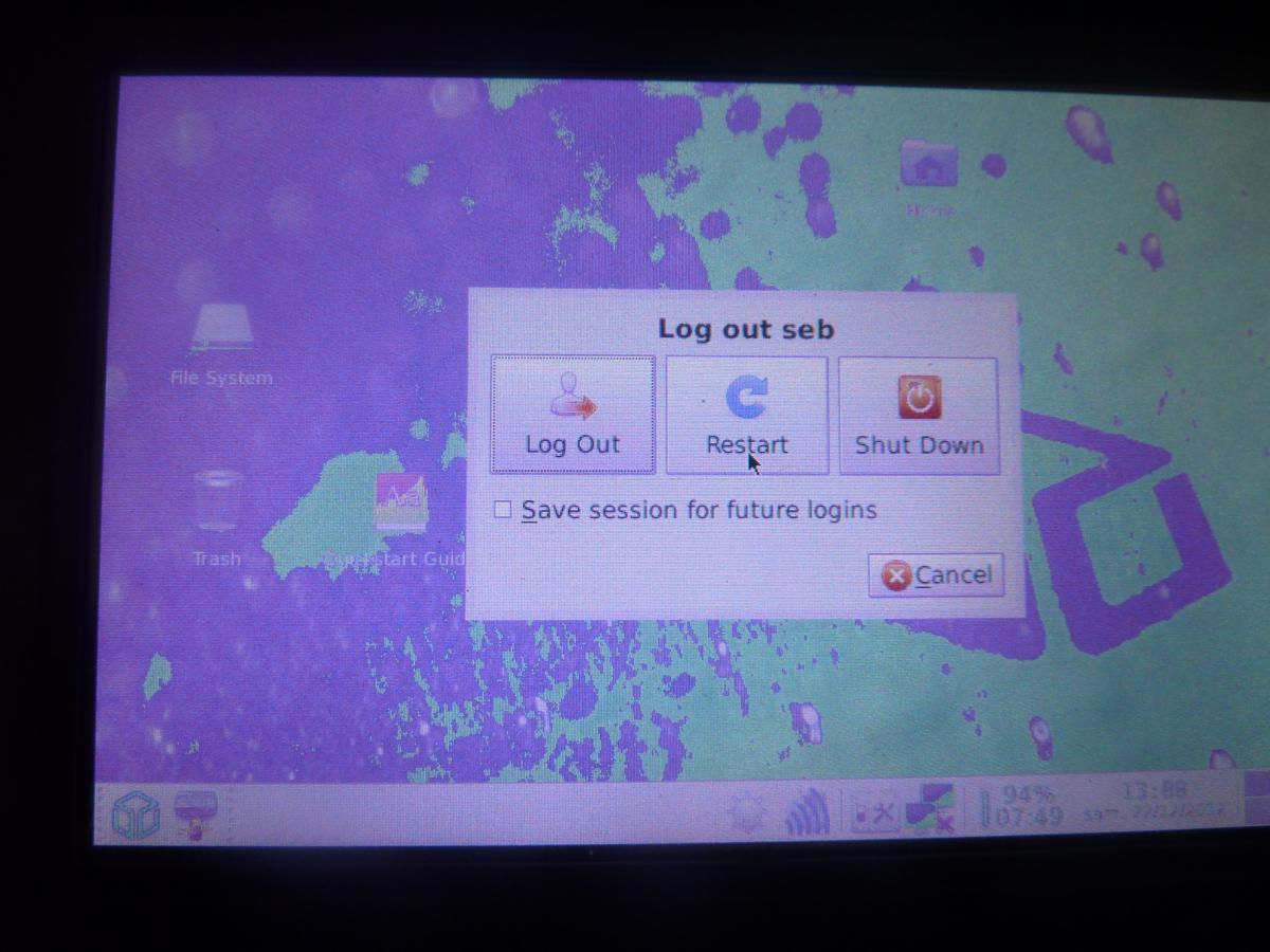

Then, once gone, the colors are still not OK, like if some green is missing (I can see green is very wrong with some cmake compile. I just cannot read the green text in terminal). Here a picture of the problematics colors:P1020543.JPG.
The green mask only happens on power on. But the wrong colors are always here.

It's the cable.
Maybe it's not well-seated at the back. Or maybe it's already dead.
I am sure i fixed it well, but like with any mechanic part, there's always a delta :/.

Be very careful that they're put in properly.
Almost all of the failed cables I got back simply teared at the side - which happens when it's too tight in the lid and one of the edges tears.

I'm currently reassembling an unit, and i understood what went wrong. I forgot the exact placement of the aluminium border of the LCD cable. Was a matter of two mm :/.
