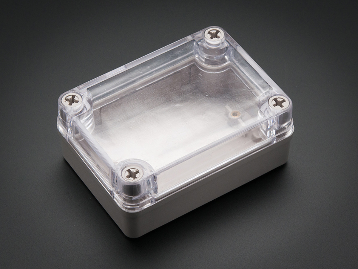

You can put your electronic project (like raspberry-pi zero or esp32) in a waterproof clear box.

Yeah, that can be done, I'd just be aware of even clear plastic going yellow when left out in the sun, depending presumably upon what type of plastic it is. Also water can wick in along screw threads, but I'd still personally prefer a screwed together box than a clipped together one in a humid or wet environment.
I'd expect the sticky they use on tapes of any sort to denature over the course of a year or so. In my experience plumbers doing external pipework mainly solder pipes together. But yeah, grease on the threads is a good idea.
