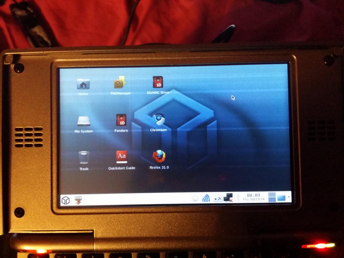

I've had this issue on my Pandora since i got it a couple weeks ago from dragonbox.
I have faint horizontal lines, it follows the mouse pointer and is visible around the icons.
Also visible in some game,s which makes it a little confusing. The device is usable, they are not That disturbing, but still it would be fun to get rid of them.
I shall try to upload a photo of the screen i just took.
Looking forward to your replies!

I have that too, and I think there is another thread around here about it.  I will post a link if I find it.
http://boards.openpandora.org/topic/16597-wanted-new-lcd-cable-tv-out-cable/?hl=%2Bhorizontal+%2Blines
I thought there was another thread where this was discussed, but I can't find it.  Maybe it was the on the wiki?
Anyway, I usually keep my stuff dark, so I forget about it until I have a lot of white on the screen, such as when I was changing my theme the other day.  Perhaps something like that will work for you until you can get a replacement cable.  I don't know if ED will replace them under warranty since they seem a bit scarce at the moment, and technically they still work.
I also would like to fix this issue on my Pandora.  Sorry I couldn't be of more help.
Edit: I did find this, which has a link to some files that may be of use: http://pandorawiki.org/Display#Internal_display_cable
Alright. Yeah the darker theme makes reading the names of the icons hard.
Bit i shaöl study those links.
And i thank you for trying atleast!
