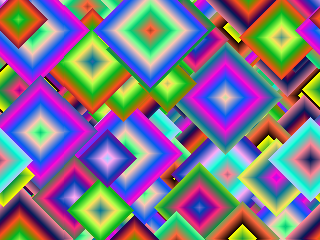

Episode 3
Summary: In this episode, I combine one of the oldest of old-school demo effects with a little gp2x-specific hack to create the beginnings of a visually somewhat interesting title sequence for the demo that requires very little code and leaves almost all of the CPU available for precomputation of stuff to be used for later effects. Total size of "demo.gpe" after episode 3: 2964 bytes.
Last time, I got the basic shell of the demo up and running, including some simple screen I/O and a button to exit. Now it's time to start thinking about the content of the demo. Many demos are divided into sections. The first section is a sort of title sequence in which the author (demo group) presents the title of the demo. Then at the end there's a sequence where the credits roll. For old-style demos that usually involves a "scroller" which is a fancy text effect in which some message is delivered, usually greeting pals in the demoscene. Newer style demos have credits that look more like TV show or movie credits.
In between these, there are the main visual effects, often with transition sequences between them.
I think for this demo I will aim for two "main" effect sequences, some sort of wipes or fades between them, a small effect as part of the title sequence, and another effect plus text "scroller" at the end. Plus music, of course.
One interesting thing about doing a demo on the gp2x is that it really does have a huge amount of processing power. Some of the hardware tricks available on old machines aren't really needed on the gp2x, which can easily redraw the entire screen every frame. However, for the title sequence, it would be nice if I could keep the CPU use to a minimum, and here's why:
Let's suppose that I had ten seconds available where I could do anything I wanted with the CPU and didn't have to worry about producing fancy effects. In theory, that would be about 4 billion machine cycles to do precomputation of stuff that might come in handy for later effects! That sounds very handy! So, to get that I just need an effect for the title sequence that is very easy on the CPU, which lets me make a nod to some of the old-style techniques.
Color cycling is an old technique in which the screen data is left alone, but a color lookup table (or "palette") is changed in real-time. This is a very cheap way of making large screen areas change their appearance without actually changing much memory. To use color cycling, I'll switch the gp2x into 8-bit color mode and then rotate a color palette to produce effects on some pre-drawn screen memory. The following code accomplishes this:
Code:
g_pusRegs[0x28DA>>1] = 0x002AB; // 8bpp, only region 1 activated
g_pusRegs[0x290C>>1] = 320; // in 8bpp mode, this means width = 320
Then the only thing that remains is to figure out how to set the color palette. Displaying no shame whatsoever, I figured this out by looking at the SDL source code. Assuming you have your Red, Green, and Blue palette colors stored in some arrays, here's code to load the gp2x palette:
Code:
g_pusRegs[0x2958>>1] = 0;
asm volatile ("":::"memory");
for(n = 0; n < 256; n++)
	g_pusRegs[0x295A>>1] = (g_pusGreens[n] << 8) + g_pusBlues[n];
	g_pusRegs[0x295A>>1] = g_pusReds[n];
A little explanation of this is needed. Register 0x2958 is the "address" representing the first color being set. Since I'm setting all 256 colors, it is set to zero so the first colors I write go into palette entry 0.
Then the colors themselves are set by repeatedly writing to the exact same register! The chip must shift the values into an internal table every time it notices a write. Green and Blue get written first, then red by itself. It's just the way it's done.
The other odd-looking code here is the inline assembly. Remember last time we had those lines beginning with colons? This is just like that. The third colon starts the "clobber" list and so it basically means that we have clobbered memory. If these kind of lines are not inserted here, a "smart" optimizing compiler might think that I'm writing to the same memory address over and over, and try to save execution time by throwing away all the work (since for normal memory all the writes before the last one end up having no effect).
The second part of the introductory "effect" will be based on changing the pointer for the screen memory location in an unusal way. Recall in episode 2 I just allocated a big bunch of memory and decided to use some of that for display instead of using the linux /dev/fb0 device. Now, instead of the usual procedure of drawing into one screen area and "flipping" the display address to a completely different memory area, I can "scroll" the screen by just incrementing the pointer by a little bit. This could be a nice technique for a vertical scrolling game, and it suits my needs for this segment of the demo because if I can avoid redrawing the screen I can use those cycles for some precomputation instead. Here's the code that is roughly what I'm using in the demo:
Code:
ul = (unsigned long) (SCREENBASE + g_nScene1ULY*320);
g_pusRegs[0x290E>>1] = (unsigned short) (ul & 0xFFFF);
g_pusRegs[0x2912>>1] = (unsigned short) (ul & 0xFFFF);
g_pusRegs[0x2910>>1] = (unsigned short) (ul >> 16);
g_pusRegs[0x2914>>1] = (unsigned short) (ul >> 16);
As you can see, there are actually two different sets of registers for the visible screen location. They correspond to the odd and even scan lines on the screen. If you want to code a special effect based on an interlace type of effect it could be fun to do it using different values for these registers (I'm thinking a cheap wipe/fade effect between scenes maybe). Otherwise, they should just get the same value as in the code above.
The rest of the effect is just simple array manipulation and not really worth going through. It just draws a bunch of "diamonds" with different colors, fills a color array, and moves the screen memory pointer around. The effect as it stands is somewhat interesting to look at (more than the old rectangles at least), but it isn't really finished. Once I figure out a title for the demo I'll work on making the demo title be part of this effect somehow.
In the meantime, keeping the effect running uses about 0.1% of the cpu cycles on the first processor, leaving 99.9% of them available for other work.
As always, the source and gpe can be found at http://members.gamedev.net/dzz/demo3.zip.
I'm going to leave the introduction sequence like this for now, at least until I figure out a title for the demo. Next I'll either tackle one of the main visual effects or change gears and start working on the music. Either one is going to be a big job!
