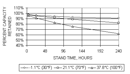

Just remember that as the system sits, even if it is off the batteries discharge. The rate of discharge is related to the ambient temperature. Here is a quote from:
http://www.cobasys.com/pdf/tutorial/Inside...technology.html
Self Discharge
The NiMH batteries, like all batteries, have a certain level of self discharge that occurs when the battery is at rest. The self discharge characteristic typical of an available electric vehicle type battery module from Cobasys is shown in figure 6. The factors contributing to self discharge include the energy used by the oxygen cycle at high states of charge. The contribution to self discharge from the oxygen cycle is negligible below about 70% state of charge. Longer term contributions to self discharge are caused by chemical ion shuttles which continuously discharge the cell over longer periods of time. The rate of the self discharge is highly dependent on the temperature of the cell. Higher temperatures yield higher self discharge rates.
Figure 6. Capacity retention at several temperatures for NiMH EV battery
NiMH Battery Applications
as far as self-discharge, that looks like roughly 10% in 10 days at room temperature...enough to be noticeable but not a matter of national security or anything :D
