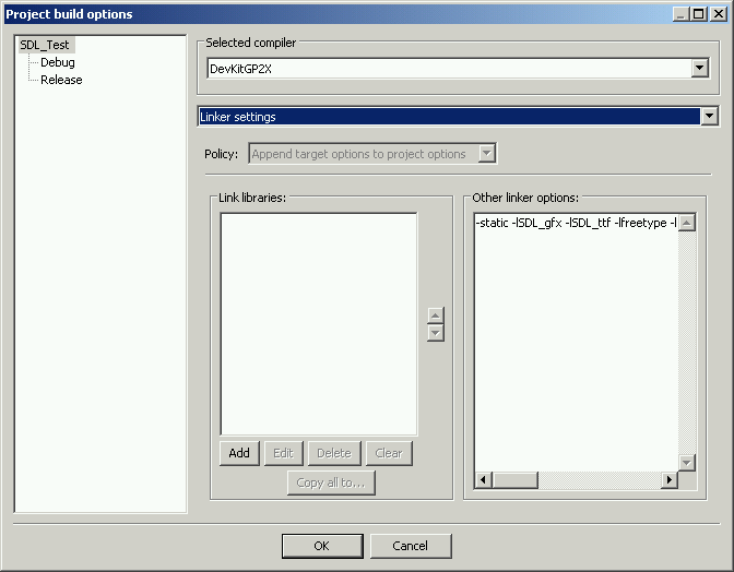

yauster, you seem to have it setup the same way as I do.
The linker tab for the global compiler window has nothing set in it. So it is only set for the current project.
I have -static -lSDL_gfx -lSDL_ttf -lfreetype -lSDL_image -ljpeg -lpng12 -lz -lSDL_mixer -lvorbisidec -lmikmod -lsmpeg -lSDL -lgcc -lm -lc -lexpat -lpthread in the linker tab of project build/linker tab/other settings list. The link libraries list is empty as in yauster's screen capture.
To get that dialogue box select Project->Build options from the menu and select the linker tab.
Putting it in the global compiler settings might be more sensible since the compiler/linker supposedly ignore unused libraries. This way it should be all set for every new project.
As for making it generate a .gpe extension : in Project->Properties there is a targets tab with a field for the Output filename. Setting the .gpe here has always reliably generated that extension for me.

I emptied the left Link List Pane and put in the line Jabberwocky said.
