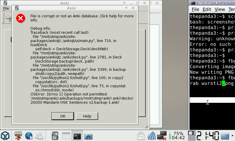

On my girlfriend pandora, there is a problem though: after downloading a package via anki there is an error message about some mounting thing. It occurs with all packages that are available. Will post a screenshot with the exact error message soon, my girlfriend is not at home atm :/

For your girlfriend's error, was the error message "File is corrupt or not an Anki database" at the top, with "Operation not permitted" messages at the bottom referencing /mnt/utmp if you scroll down? I ran into that during the course of building the port, and I think it has to do with file permissions. Thought I fixed it, but if anyone is getting that message I think I know what to do to get rid of it.

yes, that was definately the error she got. Thx for looking into it :)

here comes the screenshot:

I think I found the problem. The app itself is trying to chmod a file inside the appdata folder, but you can't do that on a FAT32 card because the FAT32 filesystem does not support permissions.
I think the true fix will be to patch the application so that whenever it fails to do a permissions mod, it ignores the problem and keeps going instead of bombing out with an error. Going to work on this today.
