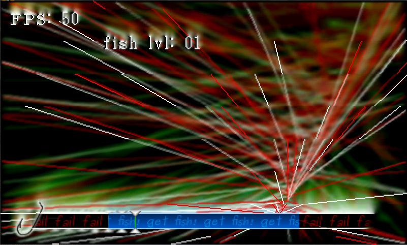

I started to decide how the fishing minigame will play. Throughout the world, there will be tiles the player can stand on marked as 'fishable', and the default action for the attack button will switch from 'attack' to 'fish' if there are no monsters within a certain radius. Once the player has decided to fish, I'll blur the background and bring up the bar graph (see attached screenshot). The reticle will bounce from left to right and back again, and the player has to use the attack button again to stop it in the 'get fish!' area. After that, I'll internally do some kind of dice roll to determine what fish they'll get and what size it'll be. (Ignore the crazy lines in the background, I just wanted something back there that wasted some CPU time to check performance.)
One problem I've run into is that the LCD on a Pandora does seem to ghost a bit more than I was expecting, making the reticle hard to see when it's moving quickly. I may have to make it bigger and/or darker and/or make the bar dark and the reticle light.

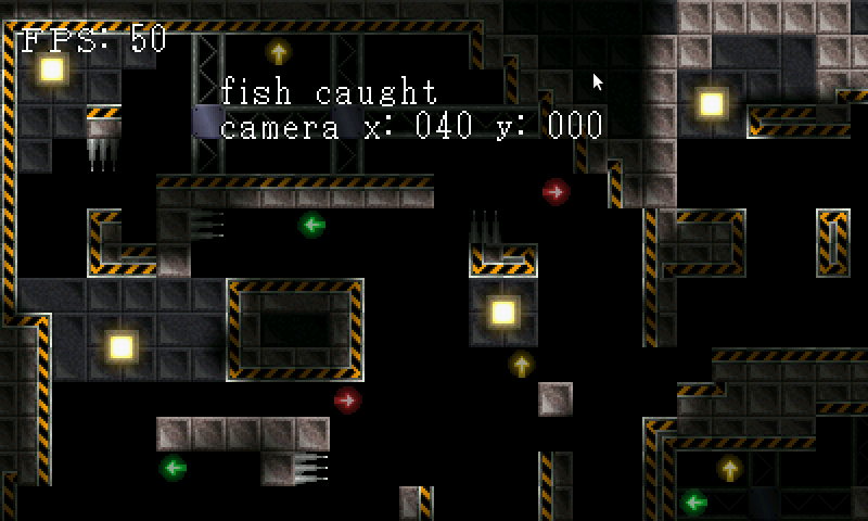

I have gotten my first map to display, although dim areas are too dim on a Pandora.
Ignore the hideous tiles, they're just test tiles from a template tileset sheet I made specifically for testing.
looking good, I am watching this :)
I liked the initial prototype, it had several minor problems, but the core idea was good, I am interested to see what you will make of that idea.
^ Is that map cut off and there more to it?
Yep - each map will be 50 tiles by 30 tiles. The worlds will be room-based, kind of like Maze of Galious, and each room will be no larger than two screens high and two screens across.

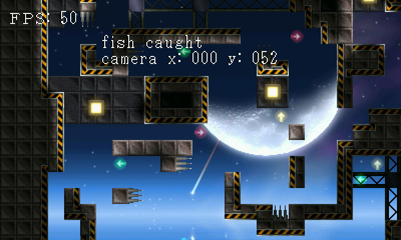

My latest effort has been on making skies and weather effects. Here's what I got so far.
You can't see it in a still, but the ocean and meteors are both animated. Once I have time to make the tropical island/karst tileset, my test map will probably look really beautiful and dramatic.
