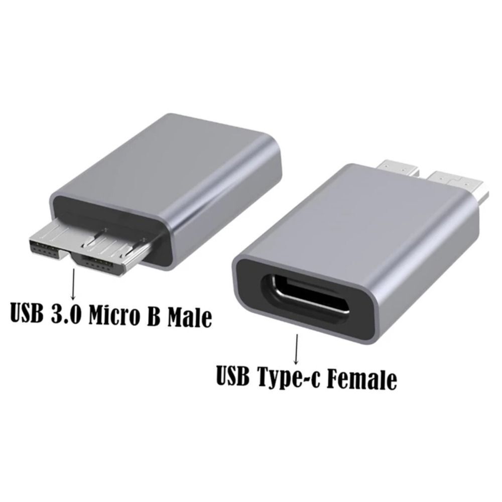

Hi..i found this interessting Thing for the Pyra Micro-USB 3 Port.
Maybe this Adapter to USB-C can help you.
Ebay Item 195592320612

2· Routing the built-in video card output through the usb port. This requires USB-C (and a conversor to microUSB 3 won't work) and of course a SOC that does support it, so far I think only medium to high end SOCs do offer this as an option.
