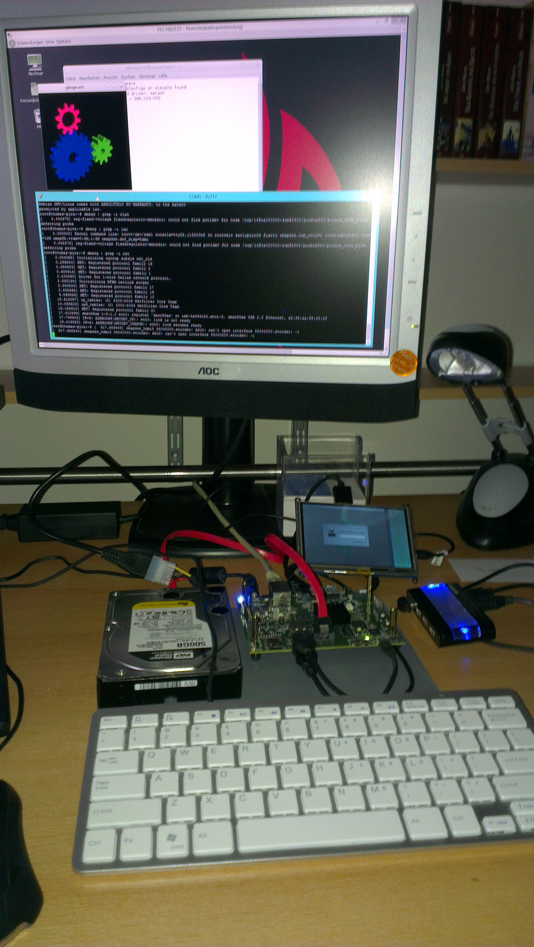

Here a picture of my dev board

=> bootz 0x80800000
Kernel image @ 0x80800000 [ 0x000000 - 0x4551d0 ]
Starting kernel ...
Thats all, system hangs.
If i connect my harddisk, my previous images from you and stevenc99 is shown in boot manager, i can boot both.
Thomas
Looks like i mixed up the MLO and u-boot.img from different versions.
Another problem is that it seems to load MLO from the sd card, but then loads the u-boot from the emmc.
I'll wipe my emmc, rebuild u-boot, rebuild the image , and see if i can get something working.
It should also be trying to load omap5-uevm instead of the omap5-pyra.dtb it tries to load on your board.
[doublepost=1466541297,1466536213][/doublepost]i've updated http://packages.pyra-handheld.com/images/extra/pyra-debian-jessie-mate.img.7z .
MLO should report itself as U-Boot SPL 2016.03-dirty (Jun 17 2016 - 23:17:24) , u-boot as U-Boot 2016.03-dirty (Jun 17 2016 - 23:17:24 +0200)
As usual, it works fine here. I wiped the first 100mb of the emmc, just to be sure there's nothing on there that might interfere.
(dd if=/dev/zero bs=1M count=100 of=/dev/mmcblk0)
