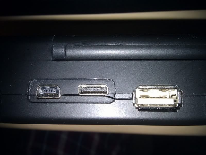

Hey guys,
I have been a very happy pandora user for over a year, but this week I found a crack on my "first 500 batch" Pandora. I noticed this week that the battery wasn't charging, and if I plugged it in without the battery still wasn't working, unless I squeezed on the back of the unit...thats when I noticed this hairline crack running from the usb port to the tv out. It is similar to other cracks I have seen posted over the year.
Here's a picture of it:
Just as a side, I have kept very good care of this, never dropped it.

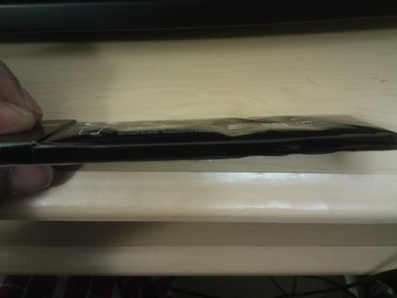

I then noticed that the battery seemed "puffy"...can't quite remember if it was like this before or whether it has gotten "puffier". The battery always did fit a little snuggly, but I'm wondering if the extra puff factor is causing the case to slowly split open.
This is it:
Is my battery messed up?
Should I attempt fixing the case by myself or try getting a new case?
My understanding is that your battery is indeed very messed up, and that you should stop using it and be very careful with it.
Absolutely contact your distributor about the battery and the damage it's seemingly done - warranty or not, it shouldn't be doing that, and they'll know what to suggest.
this has happened to people who have their pandora constantly charing, somebody else, i cant remember who, always had their pandora plugged in, for like 4 months straight, and the battery looked like it doubled in size
Puffy li-ion is dangerous. I have seen them catch fire. Be careful with it and get replacement asap.
It's not li-ion, it's li-po, which I understand makes it even more dangerous.
Just to repeat the warnings, stop using this immediately, contact OPT and organise a new battery. Looks like they could even send you a new bottom half of the case - very easy to replace yourself!
(Are you sure it's out of warranty? They started shipping in May 2010...)

I have not switched on the pandora since I discovered the battery like that. It feels like a stick of C4 too. Any ideas how to safely dispose of it?
Shooting an email off to team pandora now.
I can honestly say over the year I have had this, I have not kept it on the charger longer than I would normally keep my phone on the charger (i.e. overnight).
Are there any battery alternatives out there to the stay-puft battery? ;)
Thx again chaps. :)
None, but if you have a local recycling/disposal centre or something of that nature, it may be worth contacting them as I would guess that they may know how to safely deal with batteries like that.

This is important: when you charge overnight and wake up in the morning, has it always been at 100% with the red charge light still on? Or have you noticed the red light being off with some consistency?
Mine used to always be on, but my new unit goes off :blink: ive wondered why? Is that a bad thing?
Off is a good thing. On means it is still pumping energy into the battery even though it is full. With newfound knowledge on lipo batteries, this is a bad thing. I suspect that even a few hours every day over the course of a year will result in puffy battery.

I would really like to hear from the team and from MWeston. Maybe it's the charging (software) that isn't properly adjusted for lipo battery (?). I know someone mentioned once that lipo shouldn't stay at 100% while charging at the same time. But I have no idea if that's accurate.
For now I'll try to disconnect my Pandora when it reaches 100%. The fact that the standby only last ~24h is definitely a bit of a pain. I should probably shut it down more often.
Well, the charging chip from TI as well as the battery has an overloading protection AFAIK, so it won't pump energy into the battery forever.
The speed of charging, etc. could be a bit more optimized for Li-Pos maybe, yeah, definately something to look into, but AFAIK Michael was very thorough about that.
My battery is still going fine, and I've been using it regularly since end of 2009, so I don't think this is the charging itself.
In the same time, two Motorola V600 batteries puffed up ;)
Well, one thing to remember is that those batteries are from 2009 - it might be some had been damaged by not keeping them charged. I am recharging them every few weeks, but it might be one gets overlooked, etc.
