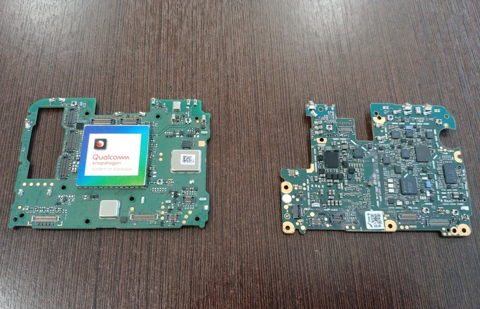

apart from the thermal restraints there are physical space restraints. here is a link to a post from hns detailing the space that is available. https://pyra-handheld.com/boards/th...-rk3399-sounds-good.83004/page-2#post-1438378
If you are expecting to run some form of x86 windows on this then there is an additional requirement that ED also brought up in one of the many threads on a windows SOC.... windows requires a BIOS. someone would have to write it . would it need another chip for it? if so how big is the chip and where does it go?
whatever new SOC is used the CPU board has to fit in the space available. the 2 connectors to the main PCB are in fixed position.
A new CPU board will not be a trivial thing to design.
We need an SoC that needs less power and produces less heat than the OMAP. Not more.
OMAP 5 is at the limit.
