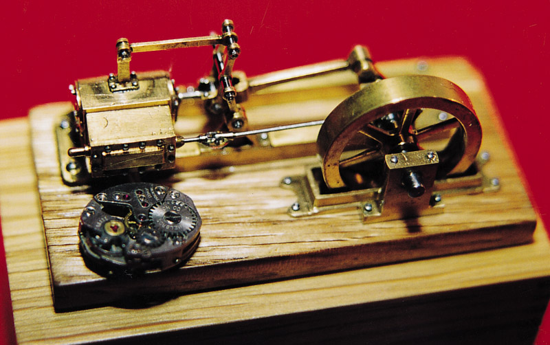

just needs a dynamo
anyone know how many aa bateries you'd need to supply a pandora with enogh power to run without its main battery? I had one of the early sony minidisk players and it came with a black plastic thing that you screwed to it and held 2 aa's which you could use to run it. Twas usefll.
