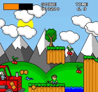

At zRichi's request, I've packaged up BubbMan 2, created by pymike. It's a fast-paced side-scrolling jump 'n' run that's pretty tough (at least, it took me a while to make it through all eight levels).
The current experimental version is available for download from my own site, while the latest stable release is available from the file archive. I'll uploaded to the app store as soon as I'm given the rights.
Short test: It starts and runs in a window, displays the game menu. But when I want to begin, it crashes and the window disappears.
