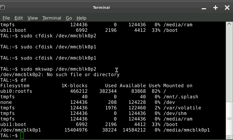

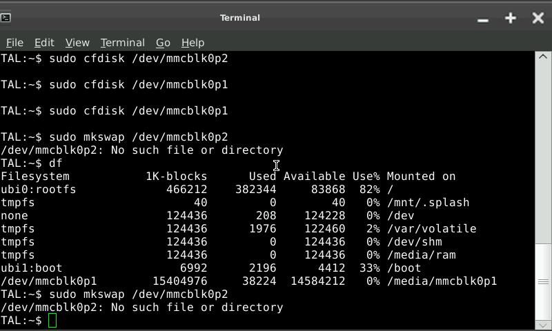

Great,but I have a problem during formating.
The swap partition cannot be recognized.
sudo mkswap /....... said no such ........
What is the problem?
You haven't given much to work on here!
What was the command you were typing?
Have you partitioned the card via cfdisk properly, and saved the partition table?
Sometimes you have to reset before it'll pick up the new table.

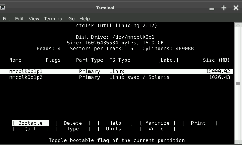

I tried several times but failed again and again.
After I made 2 partitions without formatting p1
reinsert the sd.. only see one partiton
If I formatted p1, there will be no partition information in cfdisk...
the rest 2 are the same,..
what will be the problem?
You've launched cfdisk on a partition rather than the card itself ( surprised that worked, actually... )
Your device is /dev/mmcblk0
The partitions off of that are /dev/mmcblk0p* .. where * is the partition number.
Apologies for the brief reply.. bit knackered just now.
[edit]
Also, swap partitions do not get auto mounted.
So, you wouldn't see it appear in the mount list.
You'll need to format it via: sudo mkswap /dev/mmcblk0p2 ( which would be the second partition on the first card. )
Then mount it manually via: sudo swapon /dev/mmcblk0p2
