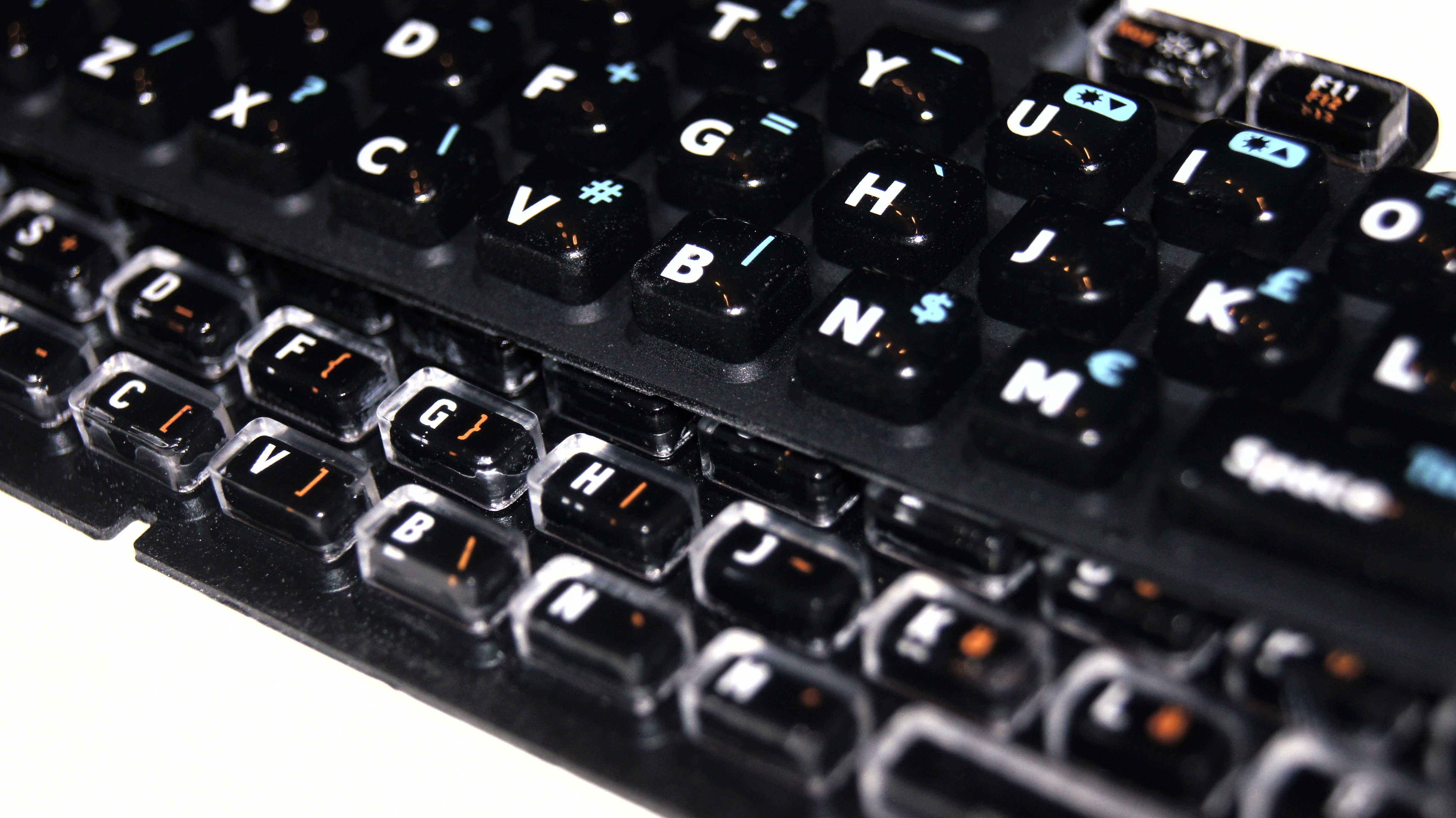

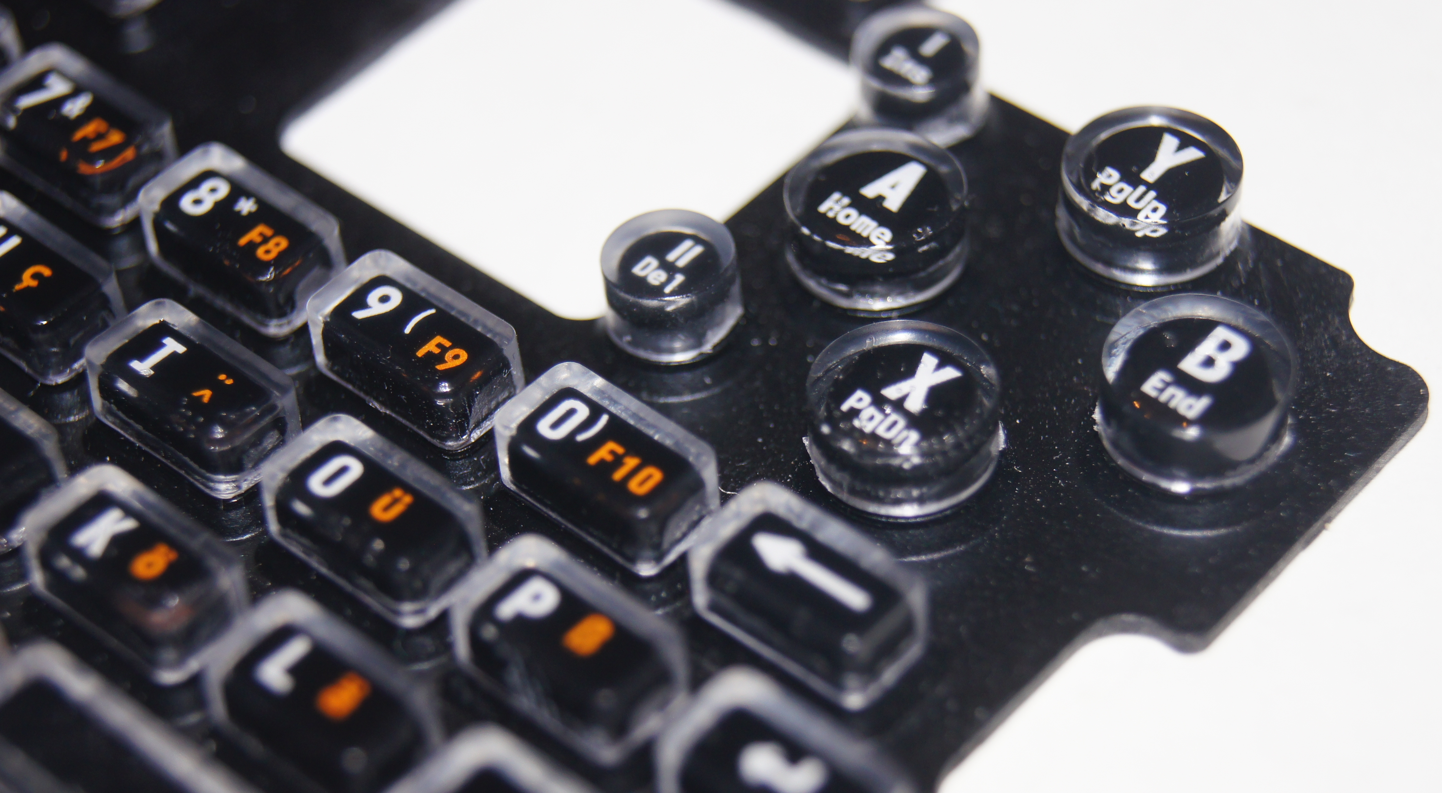

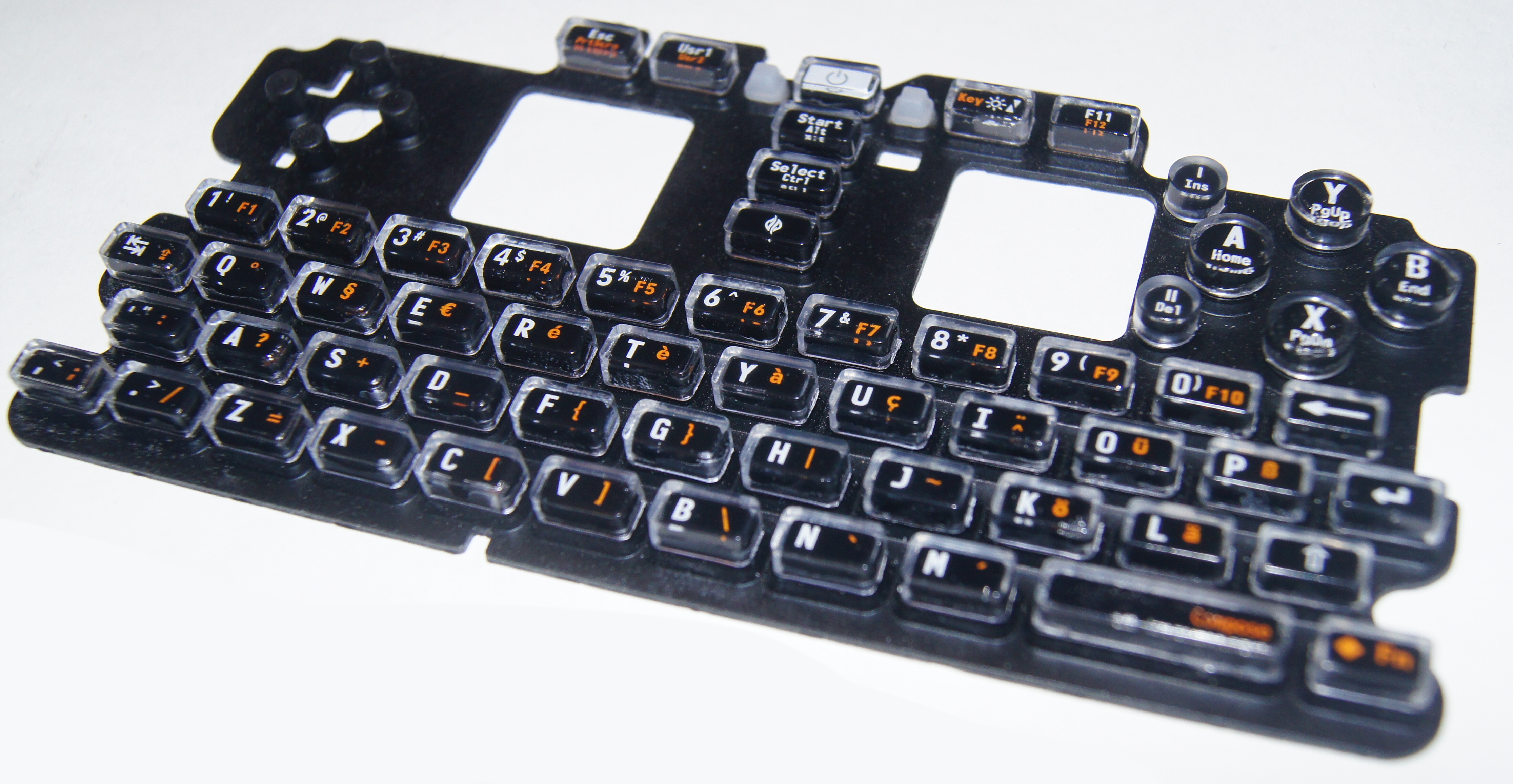

As promised, here are some pictures of the sample keymat that just arrived today!
The keymat has some issues (the glue is not properly done), but I knew that upfront. New samples which should be perfect in that regard are already on the way and should arrive next week.
I'll do a newspost with a video and some more information about my opinions of the keymat tomorrow, but I didn't want to make you wait any longer for pictures!
First, some pictures showing the keymat alone:

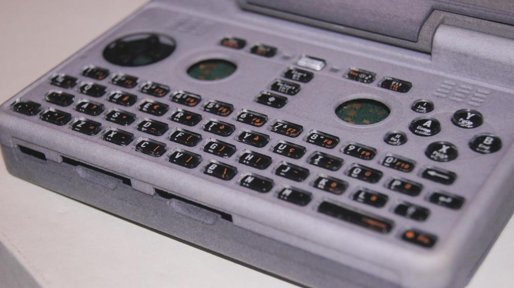

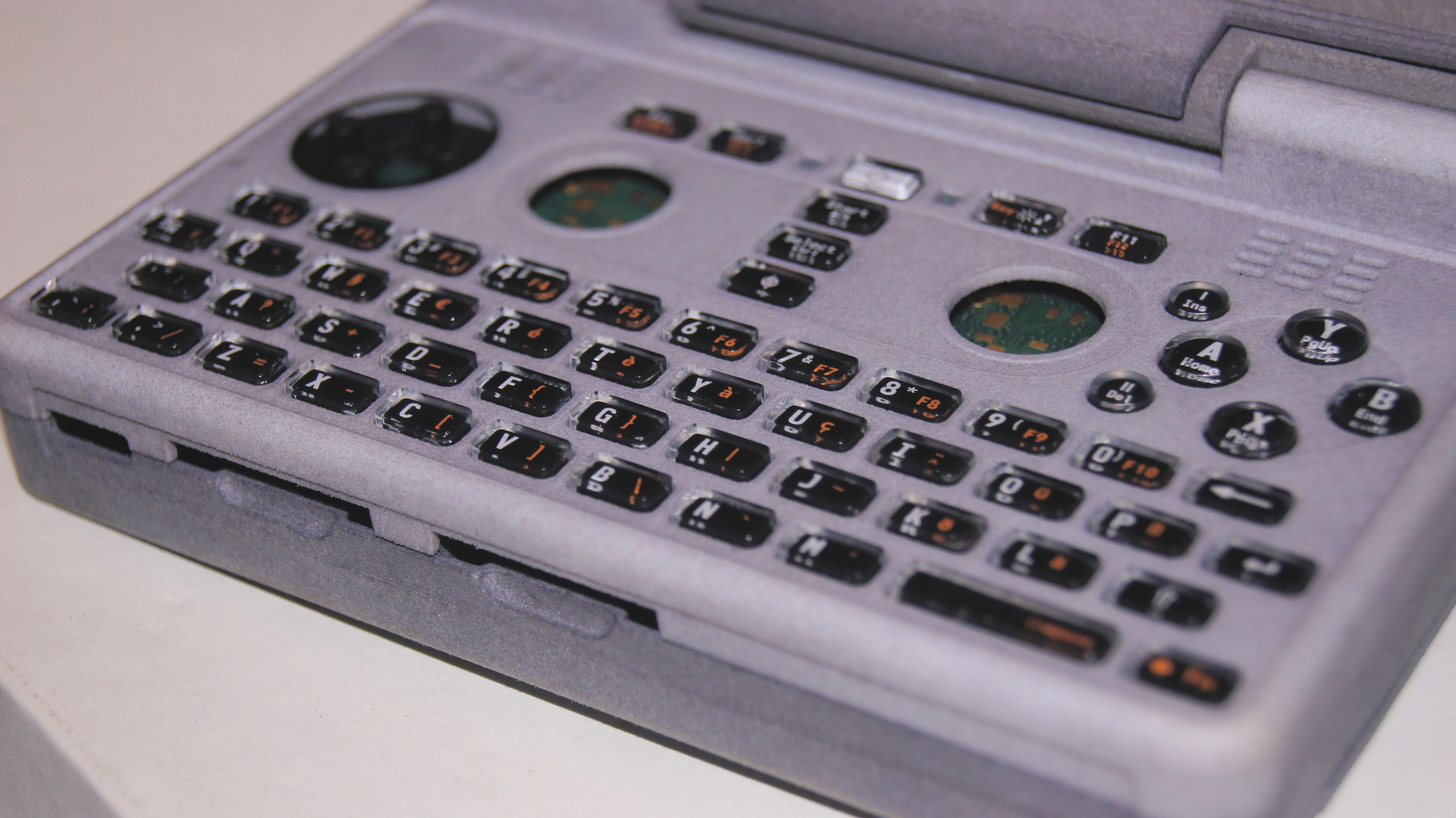

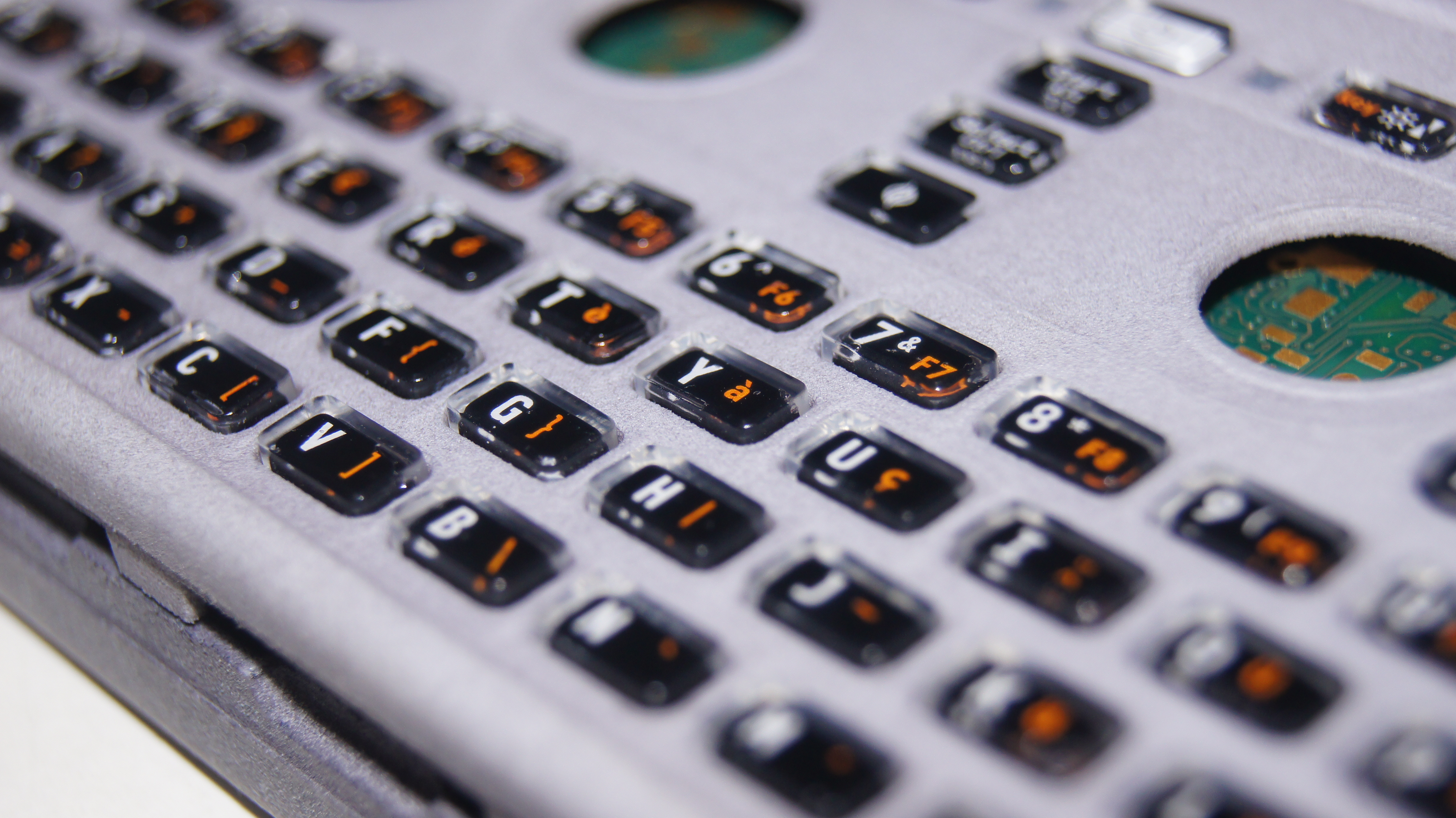

This is what it looks like inside the printed prototype case:

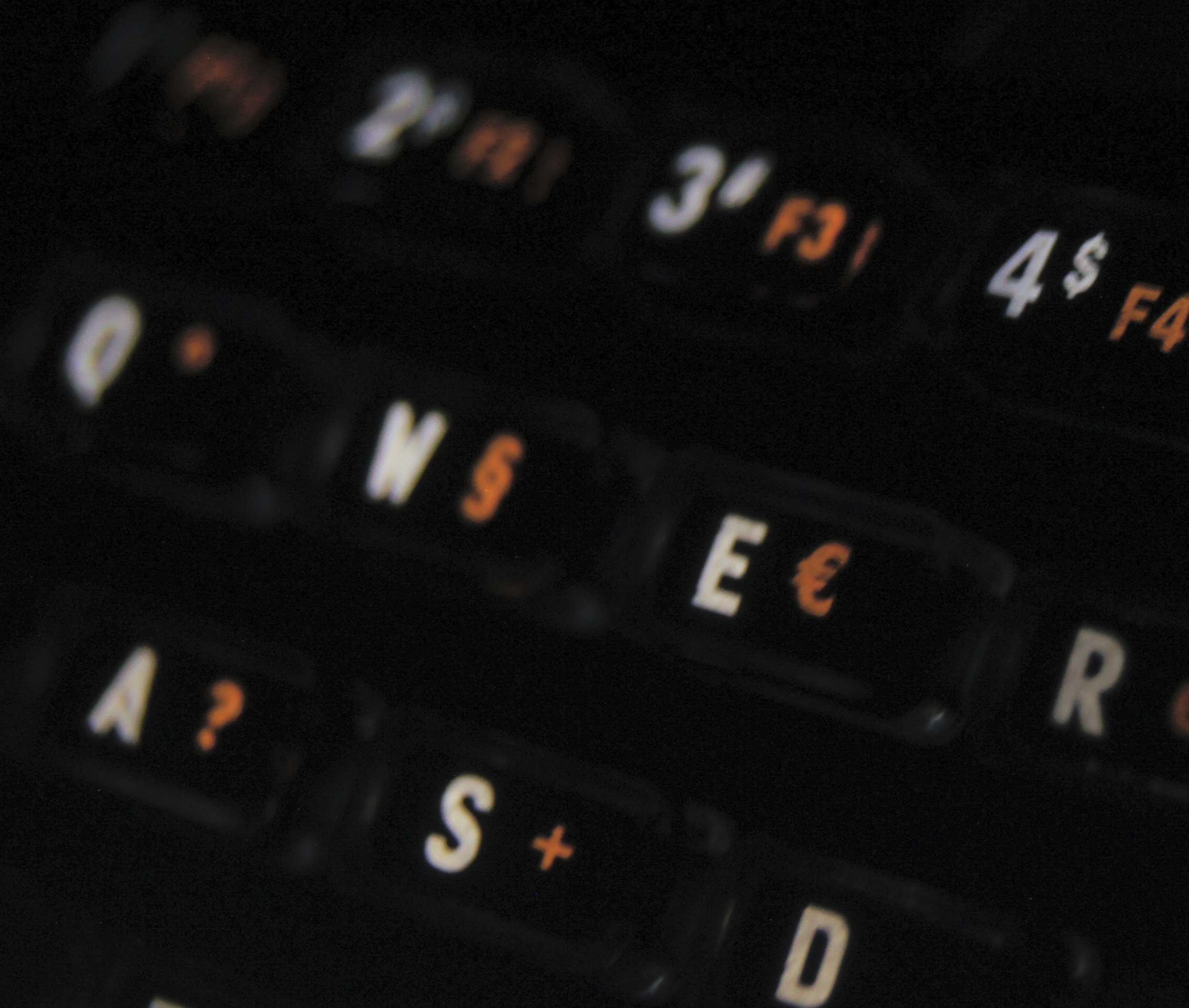

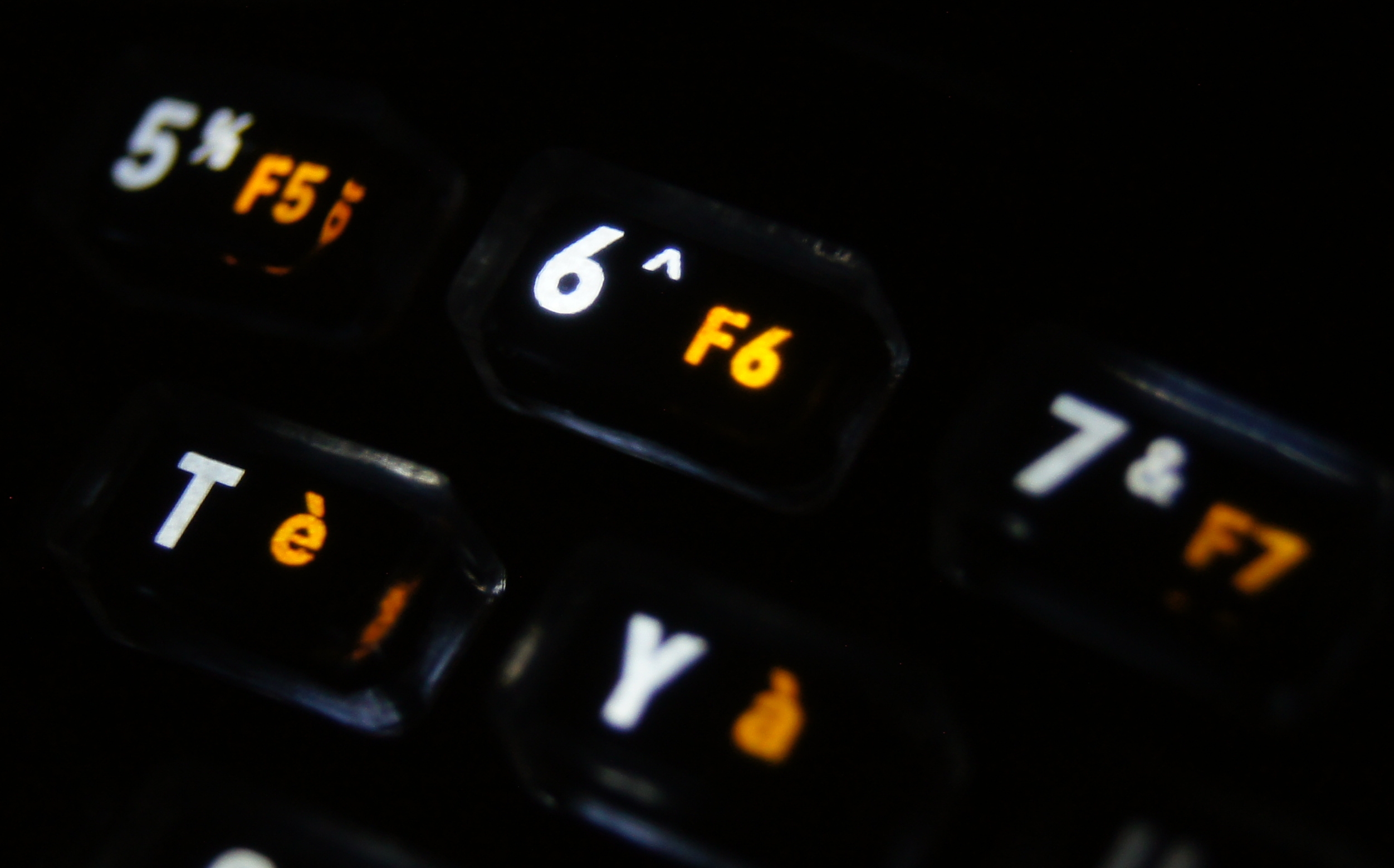

And these are some pictures I took in the dark, using an LED flashlight to light up the keys:

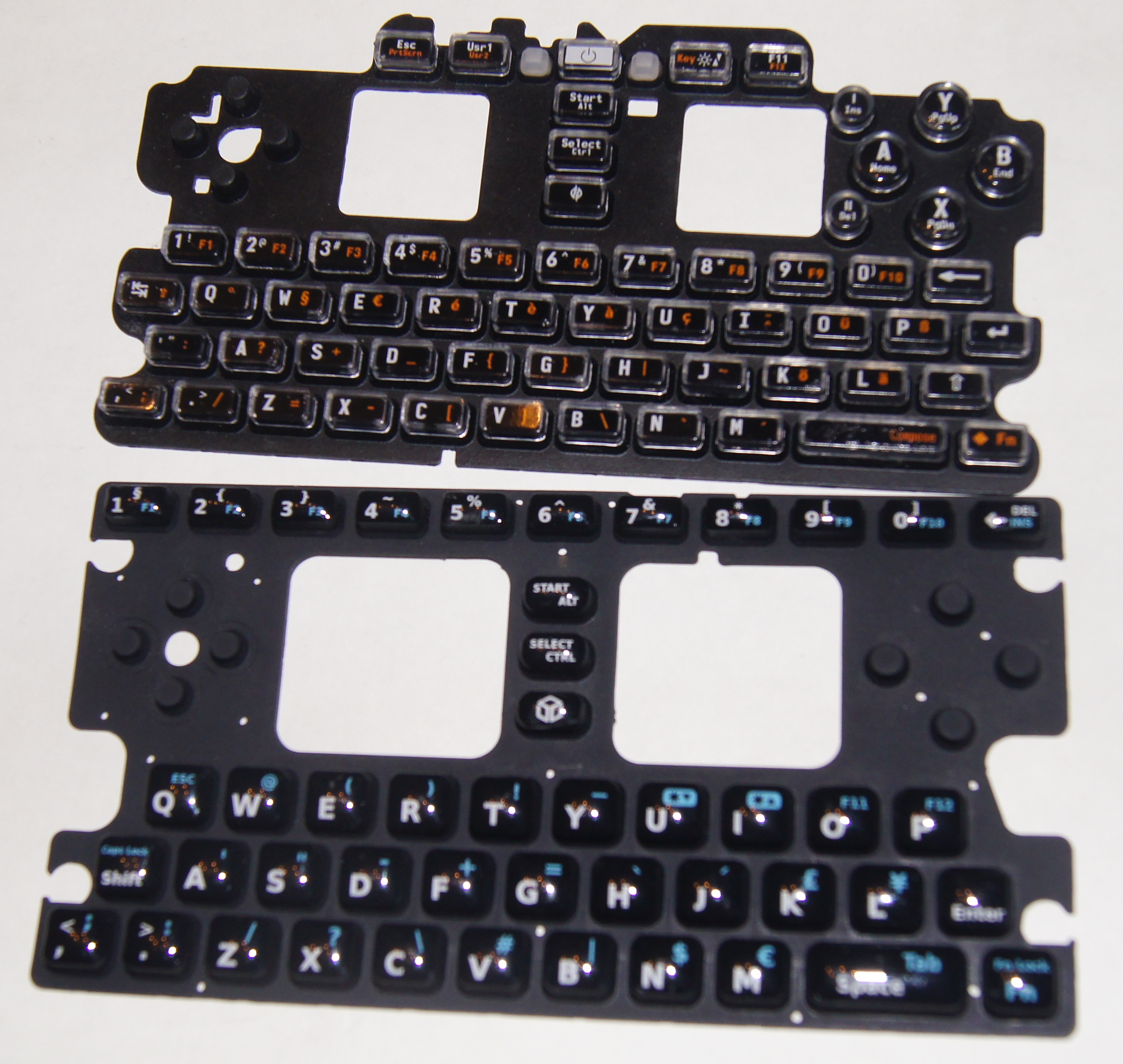

And some comparison with the Pandora keymat:

Now - the most important thing: How does the keymat feel?
I'm happy to tell you that the keys itself feel great!
The flat plastic caps have rounded edges, so they're not too sharp, and the material feels very nice.
The look of it is also gorgeous.
The action buttons also feel great. They're not totally flat, they have a little convex curving which feels nice. They are a bit higher than the keyboard keys, but I probably want to make them a bit more high.
The mat itself is a bit less stiff than Pandoras mat, so the keys are a little lighter to press.

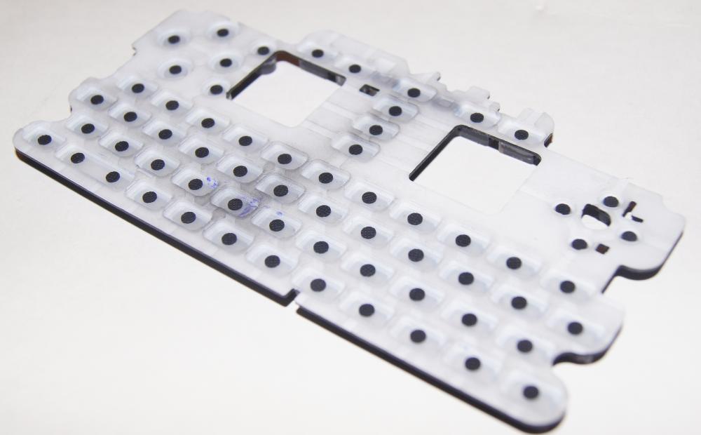

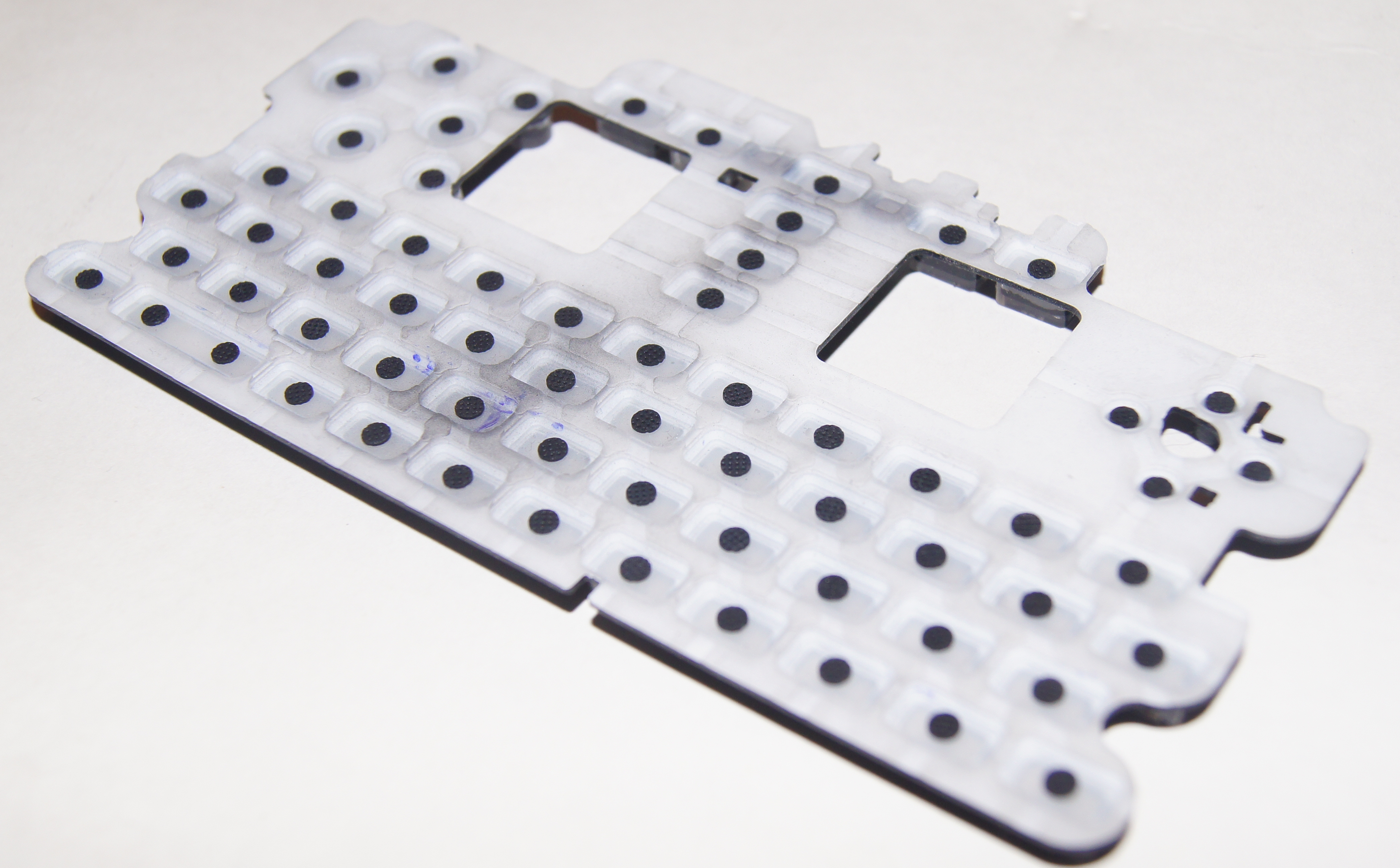

However, tactile feedback isn't great yet. It seems the travel distance for the keys and especially the action buttons is not far enough.
This can easily be proved: When the keymat is lying on a flat surface, the keys feel a bit squishy when you press them.
If you put the keymat on a flat surface but have a hole below the key you want to press, then it feels great. A perfect proof that the carbon pad reaches the PCB before the button is fully pressed.
My guess is that the manufacturer followed my design guide for the travel distance WITHOUT the carbon pads - and then, with the carbon pads added on top, the travel distance went lower.
That's no big deal though, I can easily measure how much travel distance is missing and it will be removed for the next sample.
After all, that's what samples are for - if you were sure everything worked from the very beginning, then you wouldn't need samples :)
So, all in all I'm very happy with the first sample. It looks great, it feels great, it fits perfect, the lighting works fine and only the travel distance needs to be increased.
That's a good start!
EvilDragon [Englischer Beitrag said:
Just measured them: The travel distance is 0,3mm too little. No big deal to fix, but changes usability a lot :D​

Wie versprochen, hier sind einige Fotos der Muster Tastaturmatte, welche heute erst angekommen ist!
Die Tastenmatte hat einige Probleme (der Kleber ist nicht gut gemacht worden), aber das wusste ich bereits. Neue Muster, welche in dem Punkt perfekt sein sollten, sind bereits auf dem Weg und sollten nächste Woche eintreffen.
Ich werde einen Newspost mit einem Video und etwas mehr Informationen über meine Eindrücke der Tastaturmatte morgen posten, aber ich wollte euch nicht länger auf die Bilder warten lassen!
Zuerst, einige Fotos, welche die Tastaturmatte alleine zeigen:
So sieht es in dem gedruckten Prototype Gehäuse aus:
Und das sind einige Fotos, welche ich mit einer LED-Taschenlampe durch die Tasten leuchtend im dunkeln machte:
Und einige Vergleiche mit der Pandora Tastatur:
