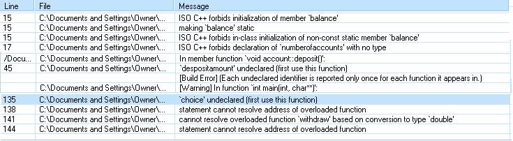

Having some trouble compiling this code:

        double balance = 0;
        string name;
        static numberofaccounts;

                cin >> despositamount;
                cout << "You entered " << despositamount;

Here are the compiling errors:

You can't say double balance =0;
You need to just have double balance;
Then do balance=0; in your constructor.
You never declared the variable choice.(nor did you put anything into it.)
You spelled deposit wrong on line 45
Also....you probably want to have break statements in your switch.
case 'd':
<do whatever>
break;
Otherwise it will execute that case ans every case under it.
I think it should also be account.deposit();
Try those and then let's see what you have left.
