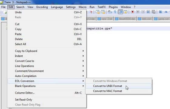

You need to create text file named autorun.gpu at root of you SD card.
Inside it you can write any valid script and it will execute an console startup.
But don't forget to convert file to Unix end of line format in Notepad++.
