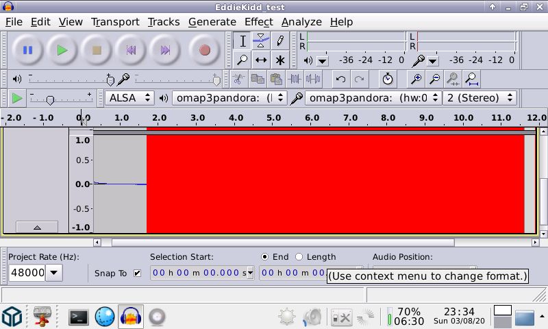

In Audacity, the signal is clipping. The red is Audacity's "show clipping" view.

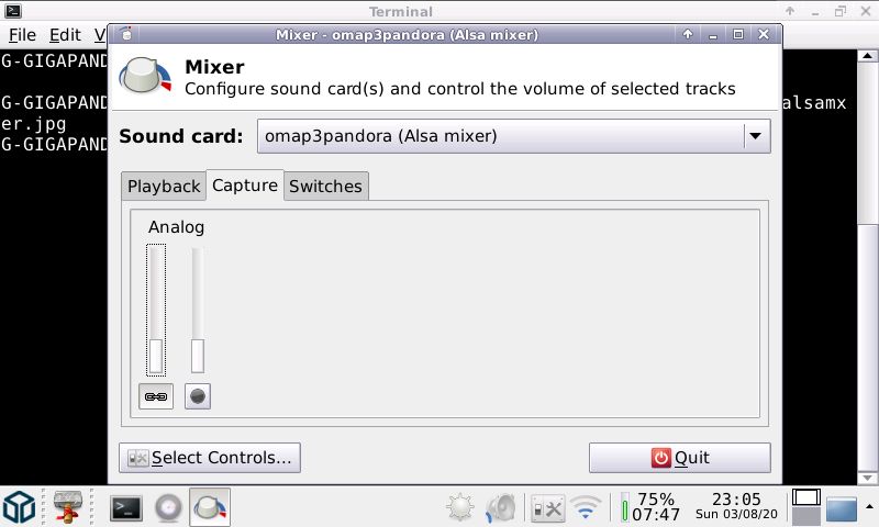

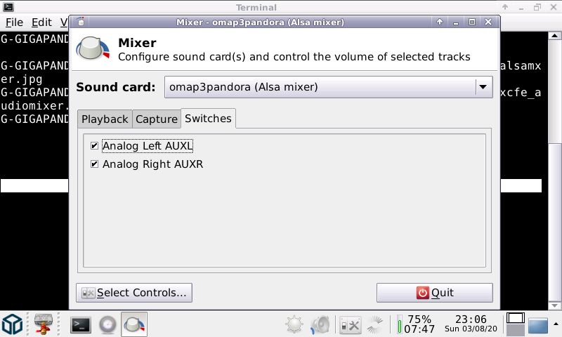

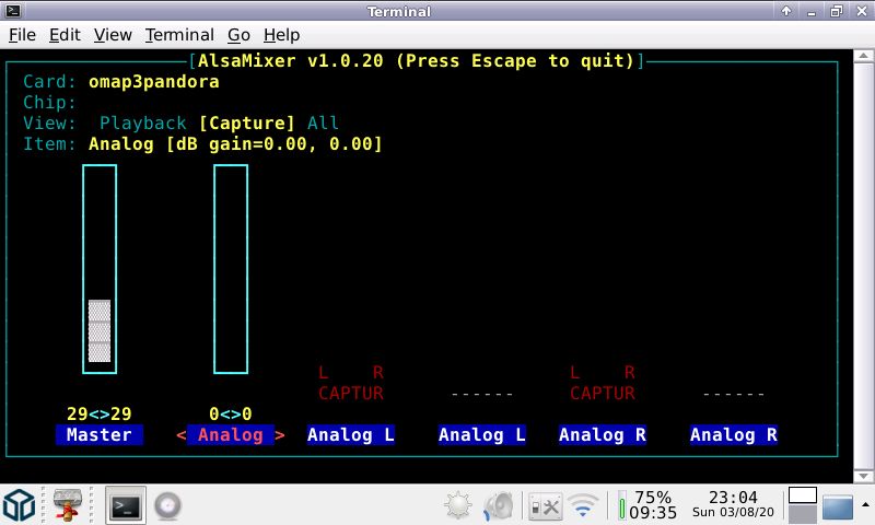

As pictures speak a 1000 words, etc., I have attached shots of alsamixer that shows that volume controls for the line in are not available. The mics I have disabled.
It seems to me that there is input gain on the hardware, that is configured somewhere in Alsa on the pandora.
