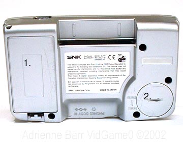

It's that time again, time to replace the secondary battery in my Neo Geo Pocket and I need some help. The spot where you pop open the case for the second battery looks like this
I can't get the back panel off, I've tried an assortment of coins and even a butter knife. Any suggestions?
Note
The plastic might have gone soft, when I ever I try to turn, it slips and I strip away some plastic.

It really should work with any coin, have you tried a non-Philips screwdriver? Those flat-edged ones, I mean. Whenever I'm in the mood for some new games, there's someone on eBay who sells four games at a time for around £12 (just cartridges, mind).

the back cover is a pain to get off, i find putting a lot of pressure on is better than turning it hard so it does actually turn, the battery inside mine is a toshibia lithium button cell : CR2032 (3volt) incase you wanted to buy one
