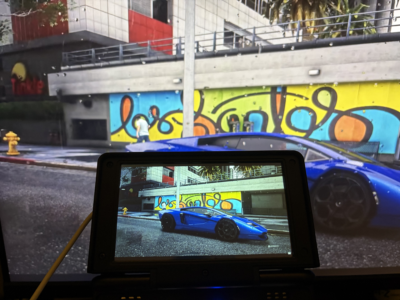

And a photo (yes, I know video would be nicer but I can't upload video files here) to show how it looks.
I'm playing a GTA-5 video so I can play with the settings on the Pyra. To get to acceptable latency and framerate you have to use unacceptable low settings. So, looking how to get hardware acceleration working and I don't know if I use both cores already.
Video quality is nice when latency is unacceptable and compression is too high when framerate is good, but I don't know if latency is acceptable to (it still feels high either case). At least wifi speeds don't appear to have much affect all of this.

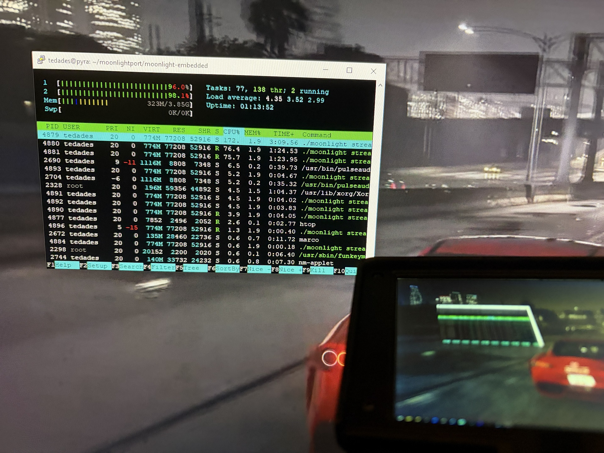

But, when using both cores to do the decoding (at almost 100% CPU) I can do ~12fps at 640x360. Which isn't the best, but it's like "playing Tomb Raider on S3-Virge in 1996" acceptable...
The resolution itself doesn't appear the bottleneck (it can do 720p to) but it's the amount of frames to decode at any resolution (too much floating point calculation overhead). So, hardware acceleration is really needed there.

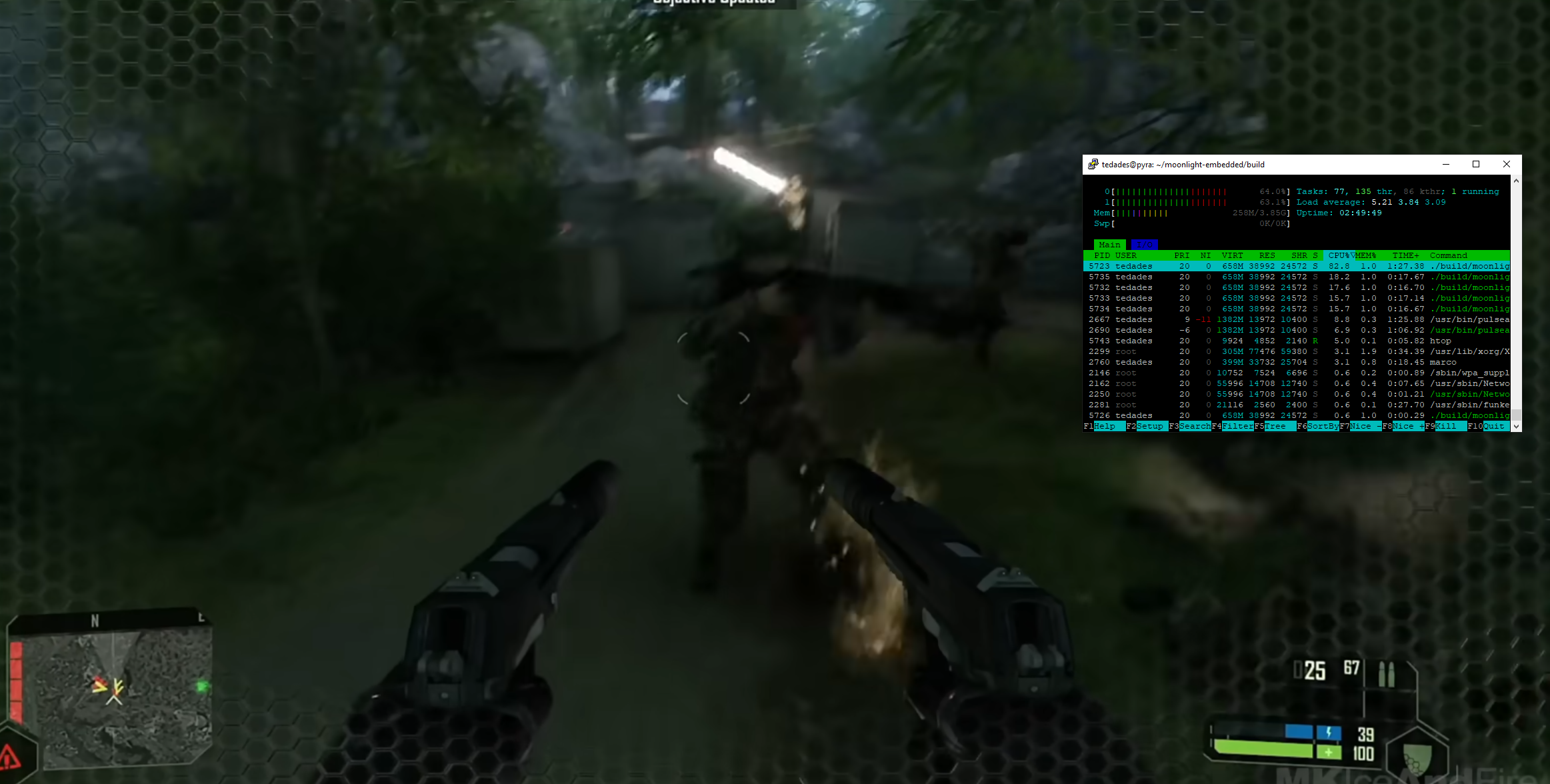

Screenshot of my PC and a terminal to the Pyra showing CPU load while streaming from that PC. It's now around 65% CPU load on both cores while it used to be 100% even on 320x180 with 15fps (mostly due to the fps above 10).
Now testing if I can package it properly so it will still work. The whole driver thing is not that stable, MESA software rendering can easily be loaded again and that will undo the hardware acceleration part (which is really required to make it usable).

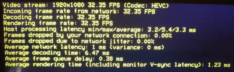

Does your Moonlight build have the GUI? There should be an option "show performance stats while streaming" under advanced settings.
If no GUI maybe there's a flag to start it with. Do I read that right, you get lower delay with a higher FPS setting? Seems unintuitive, would expect the opposite.
It is lacking the GUI but it still should have all the functions to calculate these metrics. So, I might have to write them to screen myself or log them periodically to some file.
