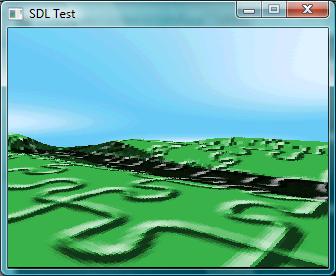

Thanks for your help - on the PC my simple 3d Voxel thingy does around 600fps - so will be interesting to see what the gp2x can get.

just out of curiosity, is it a real voxel engine (using raycasting) or using zbuffer/painter's algorithm polygons?
about speed: gp2x suffers from low memory bandwidth to the SDRAM. but when stuff is in cache it's quite ok. also note that the ARM9 is not a superscalar cpu like the pentium, nor does it have L2 cache.
arm assembly is the best, love it more than 680x0.
It draws the landscape from front to back, using a second bitmap to tell it how many pixels to draw upwards to create the height.
It also uses an array of previous heights to work out if it needs to draw anything to the screen, so if say there's a big hill at the front, it wont bother drawing anything behind it - with any luck that array would stay in cache and speed things up nicely.

Well my engine works the same way as my old Amiga one running on a 14Mhz 020, but with the addition of height mapping.
