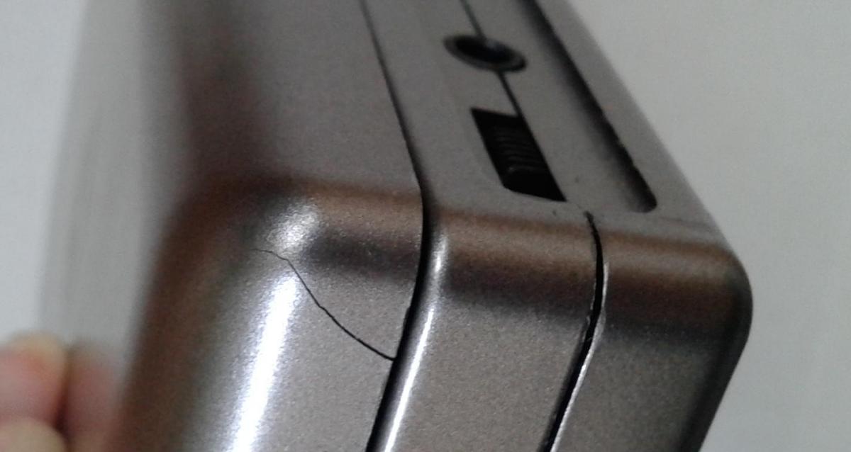

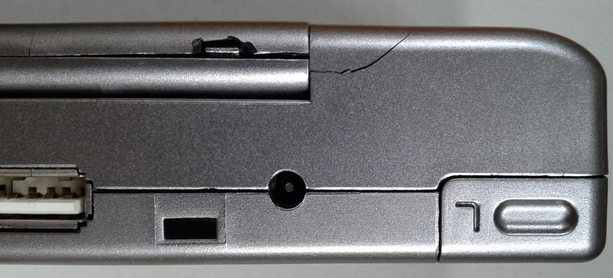

I bought a cheap CC unit from GBAX in May. In retrospect after having seen another Pandora, I think it wasn't quite assembled straight. Anyway, the case is starting to crack up (see photos). Also the charger doesn't fit into the hole any more. I haven't dropped the unit or anything like that. If I keep using it and charge over USB, are the cracks likely to start damaging the internals? Is there likely to be anything I can do to make the case fit together better? (Since I ordered with Paypal, I was protected from the possibility of non-delivery or DOA. But I certainly wouldn't send it back for repair at this point.)

In theory, if sharp bits of plastic come loose and start rattling around inside the hinge or the case it could do some damage, but in general I'd suggest it's pretty safe to continue to use the unit even with cracks.
It doesn't look like an issue of case fit to me - just general case integrity. I wasn't aware there was that much variance in robustness between different silver cases, but mine has scratches all over it from that various times I've let it fall somewhere. No cracks yet though.

I think there's something wrong with my charger connector. The metal peg isn't in the centre of the hole, and the charger not fitting isn't because of the case at all.
There was something odd about the charger connection from the beginning, and I might have gradually damaged the case by using too much force to insert the charger...
