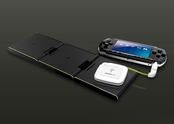

The Powermat doesn't magically charge any type of device.. the iPod / iPhones and such need a special case that has a induction coil that allows it to properly charge from the powermat..
^ so the question becomes:
Will there be an induction coil add-on for the pandora?
I think you only need an Powermat Adapter for the Sony PSP, its the same AC Connektor as the Pandora has..,
(i dont know if its right..)
Sure it will most likely work, but if the coil plugs in like it's shown above. I don't see how it's any more convenient than just plugging in the power cord.

There isn't any magical power source to the Powermat it plugs into an AC outlet.. it sends out an electromagnetic field and the other coil receives the field and converts it to current.. THIS IS HOW A NORMAL WALL TRANSFORMER WORKS.. a regular wall transformer is just two coils with a rectifier circuit to convert it to DC and a regulator to bring it to a certain voltage (simplified explanation). A transformer is closely wound together to be more efficient, unlike the powermat.

It's wireless in the sense the devices it charges doesn't require you to connect a wire to it, but the charger station is still powered by AC.. This company sells special cases / adapters for popular electronic devices with these receiver inductance coils built on that work with the charger station. It's pretty gimmicky IMO they make a killing on these add-ons for what a second or two time saved by reaching over for a cable and plugging it in?
