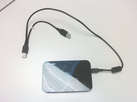

I've tried a wall charger, a normal usb, a two headed usb cable (for those power hungry hard-disks), a car usb charger (those that comes with gps navigators) and nothing. In fact, right now the battery just have a 4% of charge left and when I plug the usb in, the pandora turns on, boots up, discovers it has no battery, and shuts down, and stays like that even with the usb cable plugged in.

I was worried because the wall plug I was using still refused to charge at that level, however I then tried a pc usb using the two headed cable and luckily, it worked as expected. I've used that charger every time I tried to do so that explains why I thought it didn't worked.

100ma is not enough to charge the Pandora. Your double headed cable supplying 200ma might just be enough. I imagine that switching the Pandora into hard drive mode (when ED finally gets around to setting it up so you can do so ;) ) will make Windows supply the full 500ma and charging via USB will be a lot better.
Just out of curiosity, can you try a cable like this one?
