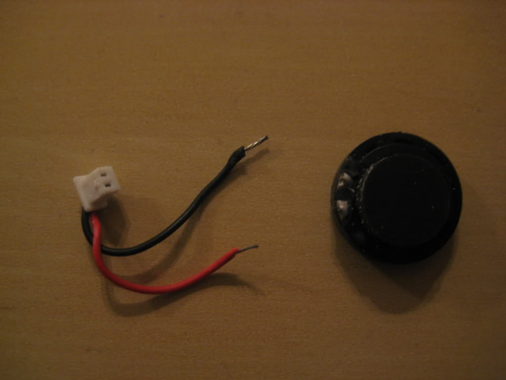

Here's a pic
I guess the wire can be soldered back on, I'll have to buy a soldering iron and give it a go. :unsure:
From the picture, it looks like it's easy to repair, since there's no visible damage to the speaker itself, just the wires came loose.
If you don't trust yourself on repairing it, I can do it for you just for postage costs.

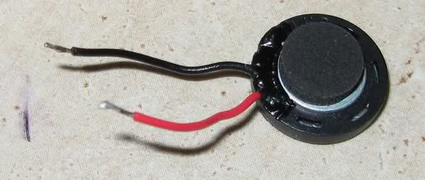

Is this what you want?
15mm across.
Yours for £2 if you want it, sent 2nd class post (included). Think I desoldered it from an old GP2x mod. Pretty sure these are from a GP2x (compare to yours). As you see, you just need to solder the wires to your GP2x mobo. Or.../...and...
I also have the same speaker with the white plug (as per your pic) if you prefer.
Choose between them, or better still, how about £3 for both (inc postage)? Cheap deal!!
(can send recorded delivery at extra charge, but frankly, standard post is pretty reliable!).
I am Hampshire, UK; so happy to take PayPal or Post Office cheque or normal cheque if you prefer.
PM me if you are interested.

Had to test my soldering skills in the end as the white plug was the wrong size, they must have changed it in one of the revisions.
Good news is that I appear to have been successful as the speaker is working perfectly.
