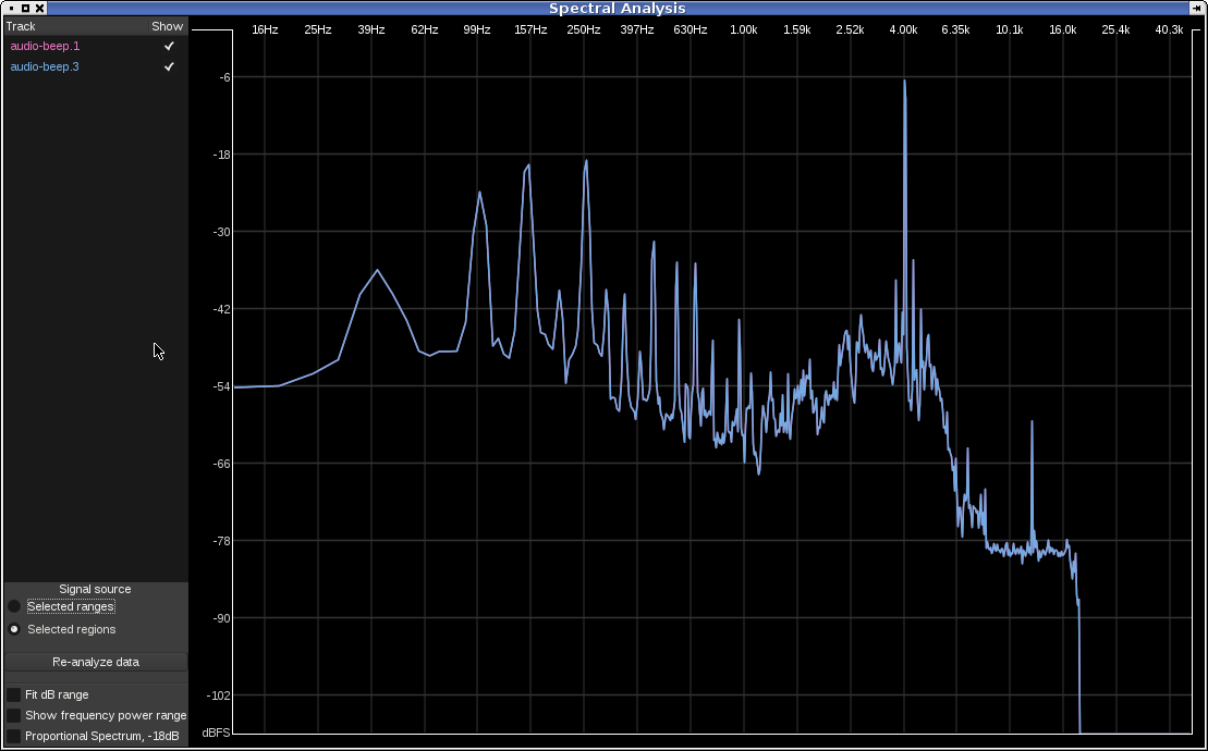

Could you try to spot the frequencies with some tools ? Maybe by opening your ogg file in a spectrum analyzer software. Could give a hint on what technology is causing this.
From Ardour spectral analyser :
[doublepost=1478872733,1478872558][/doublepost]Definitely a 4kHz noise :

Do you have some portable device that works without mains power that is affected?
If so, you could try to capture the sound from different positions and try to pinpoint it via it's volume.
