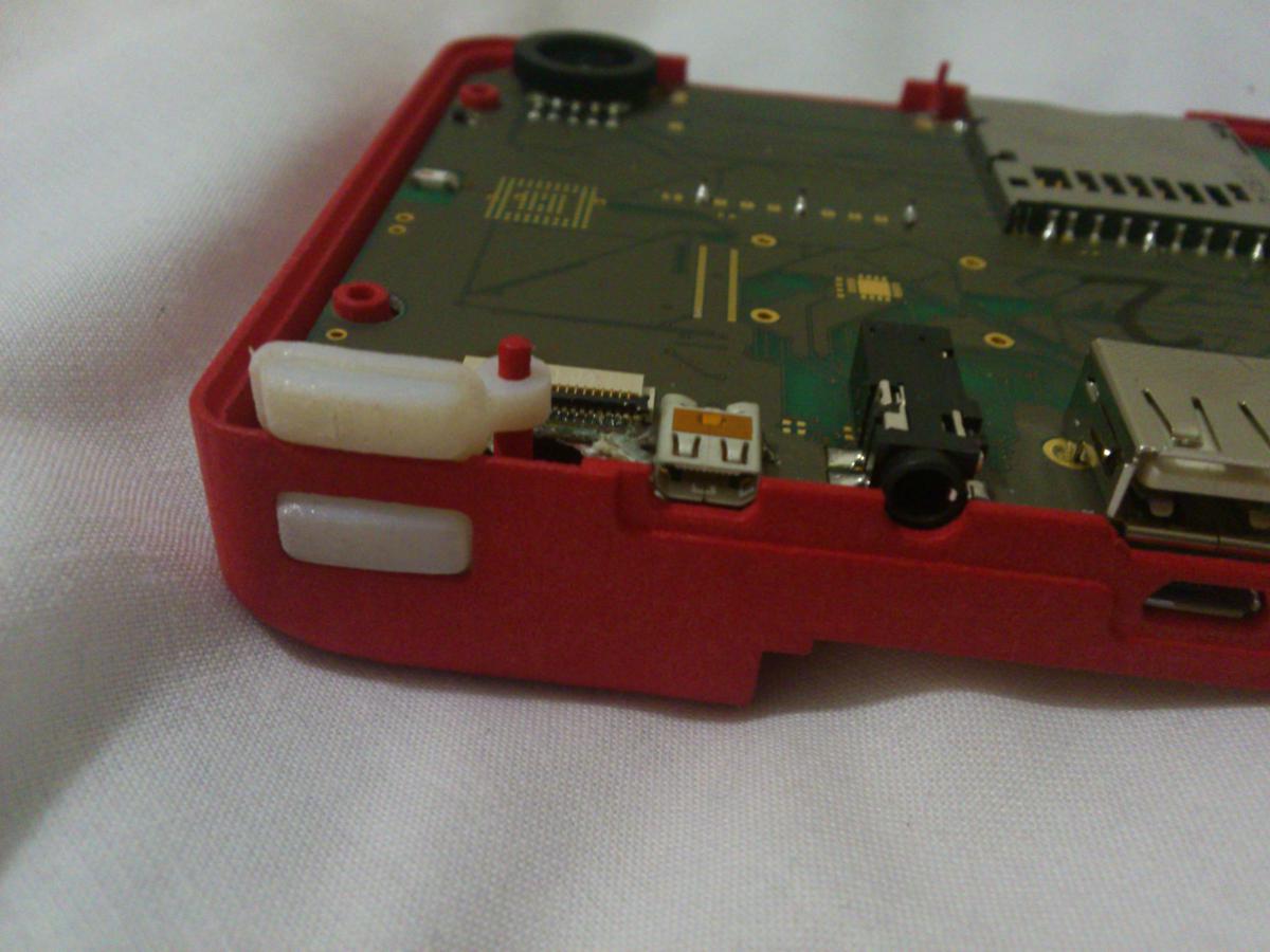

1. The case

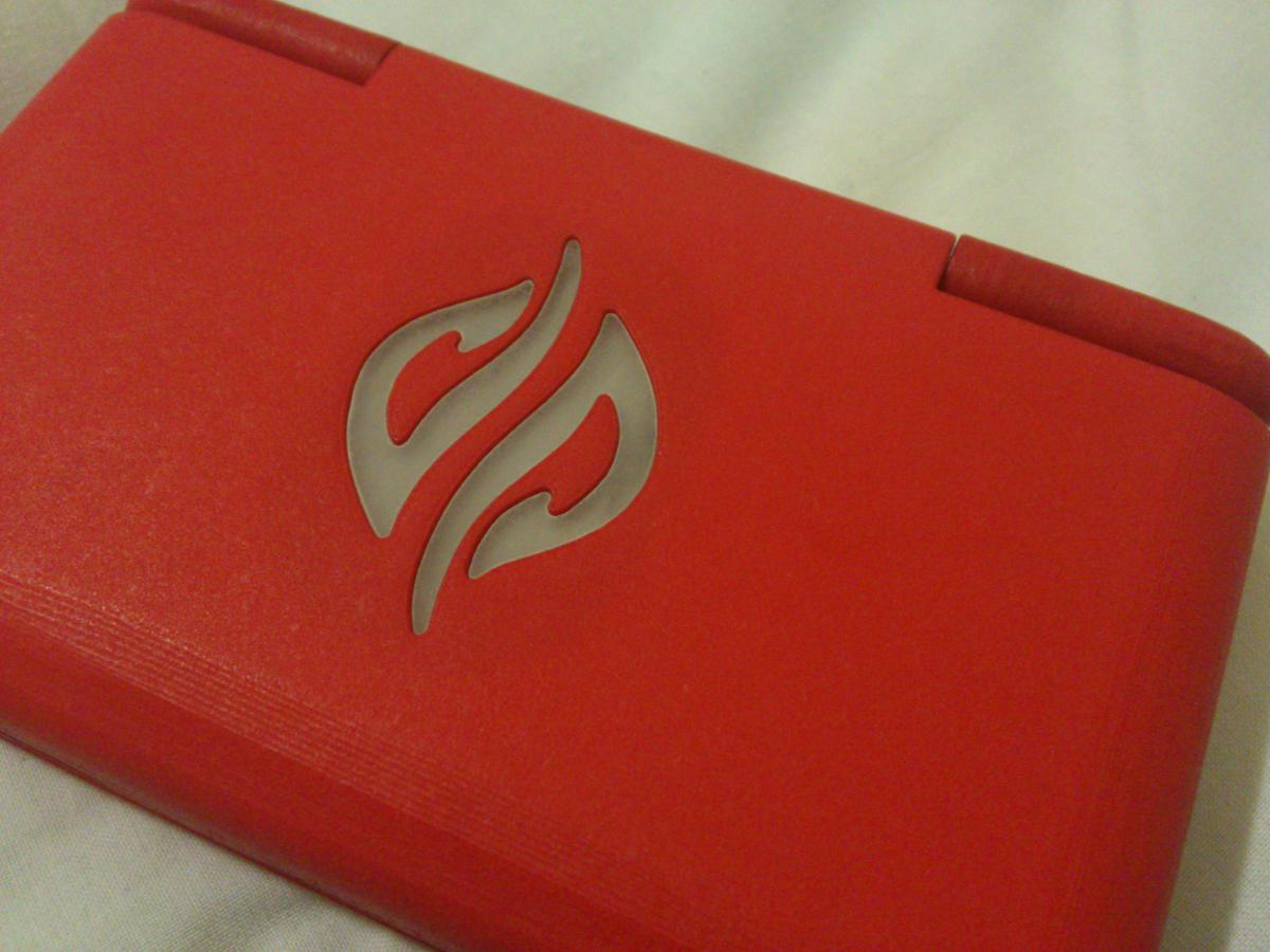

I've received the latest version of the case including the logo in the lid as well as a first version of the shoulder buttons.
In case you wonder why the color is red:
The colors used for the prototype cases have nothing to do with the final color.
I've simply decided to use a different color for each case revision, so that I instantly know which revision the printed case part is.

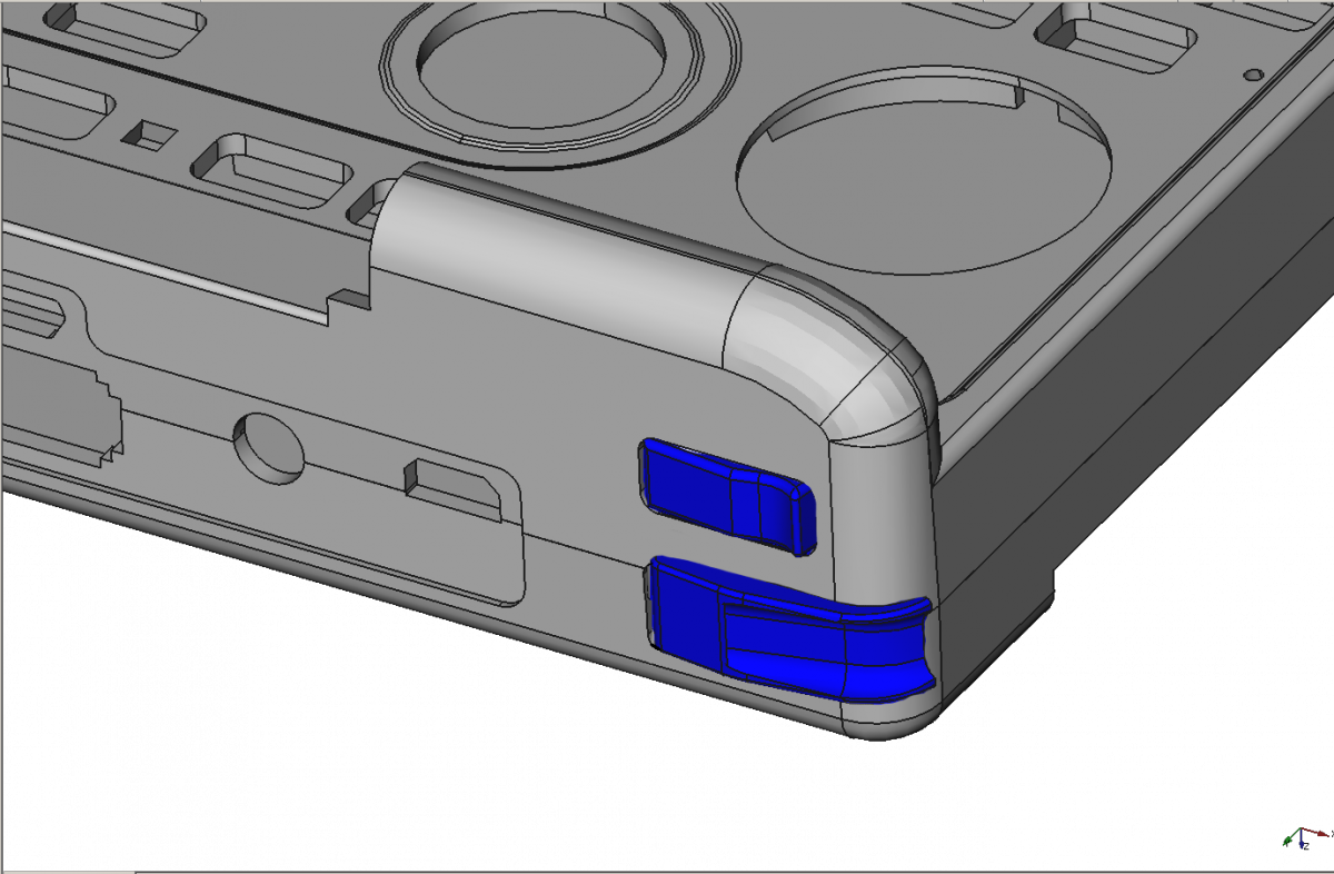

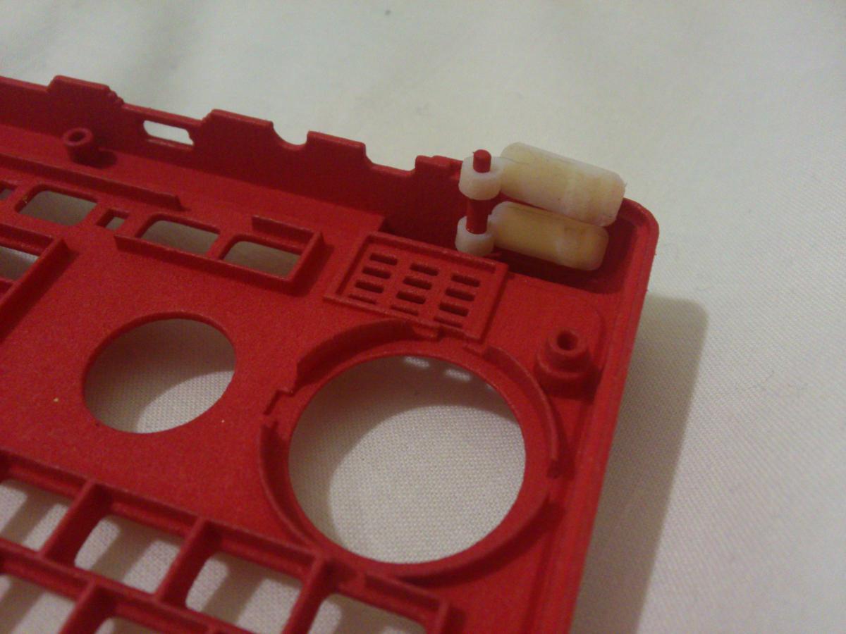

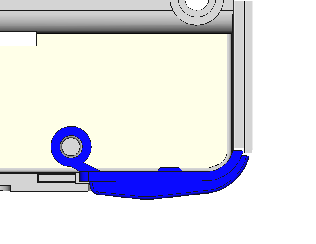

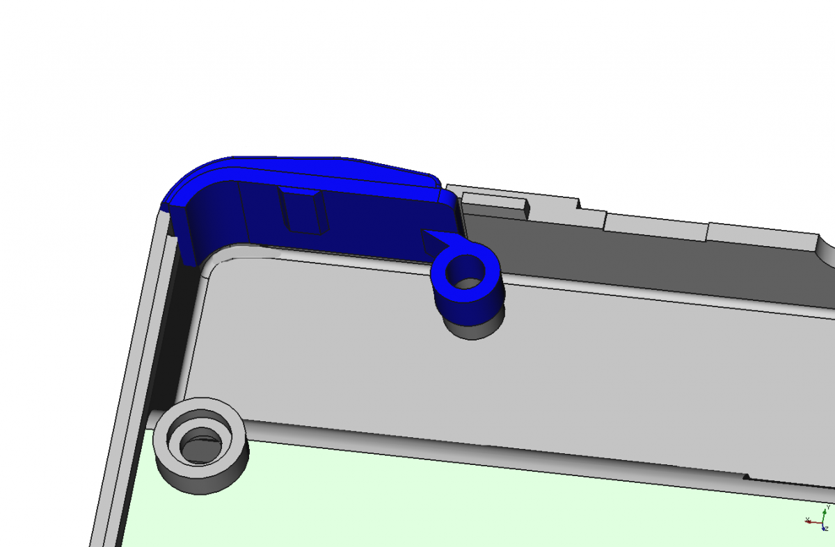

The shoulder buttons work fine physically, but I want to change the design to be more comfortable and easier to use.
The lower buttons should go around the corner and and have a small slide where you can rest your fingers in.
The upper buttons should have a small (smooth) lip which should make it easier to feel and press them.
I've made some small models using FreeCAD how I can imagine them and sent them to the designers.
It's pretty ugly, but it's just meant to be a small dummy to show the way I'd like to have them - the designers job will be to make them look and feel good (... and I've never done any CAD before ;))

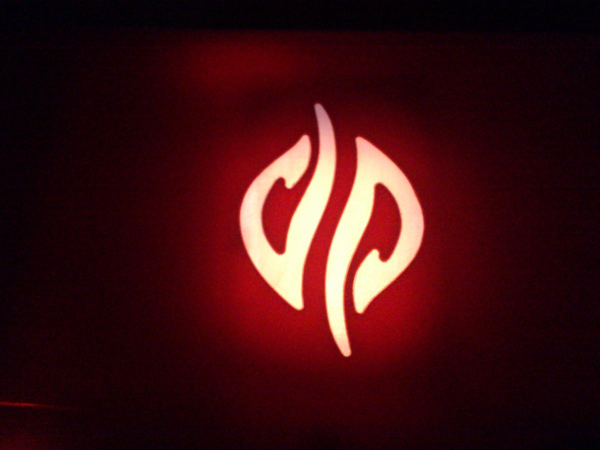

The logo is a bit too big in my opinion, but that's not a complicated change.
I want the logo to be as invisible as possible (except for when the LED is on, of course).

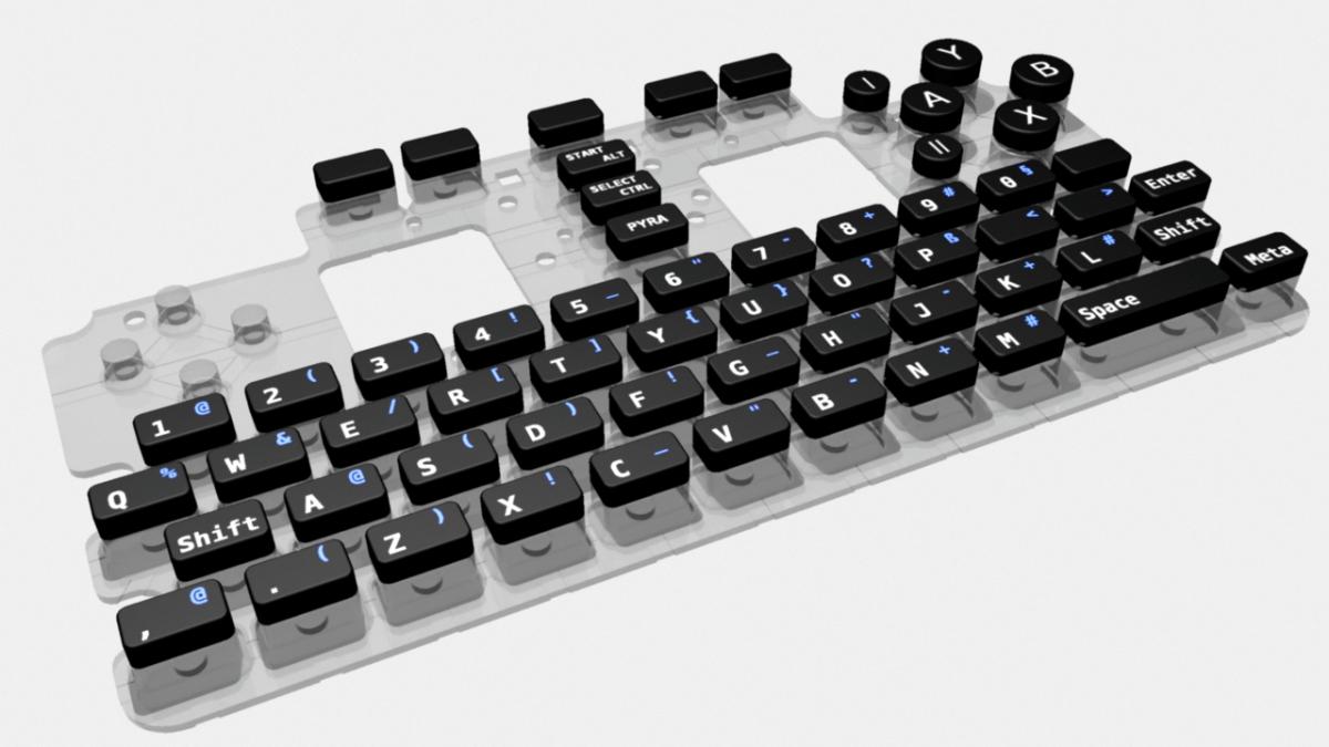

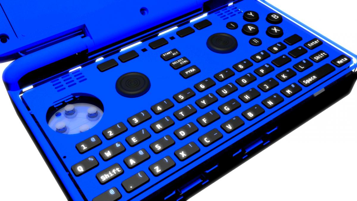

The keymat will be totally different compared to the Pandora one.
The Pandora has a rubber keymat with silk and an epoxy blob on top.
Pyras keymat will consist of a transparent silicone with black plastic keys glued on top.
The plastic keys will be produced with they're own mold, so they can freely be designed to be similar to laptop keys.
The labels will be transparent and get an LED backlight (which can be dimmed to any brightness).
The carbon pads will get some small pegs around them which ensures that keys don't wobble but move straight down.
I should get a prototype keymat soon (hopefully before GamesCom in August) which consists only of a small area of keys (Space and the keys surrounding it) which will be cheaper but good enough for testing the look and feel.
Attached are a few picture showing how it basically will look like (please ignore that the keycaps are flat here :)))

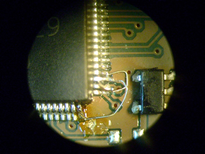

Nikolaus had a small error in the wiring for the Solomon chip, but already fixed it: two traces were switched. A trivial fix - except for that everything is pretty small.
Here is a microscopic view of the fix. The wires you see are about 1,5 times as thick as a normal human hair... so yep, it's pretty small!
The Solomon rotator chip is now up and working. Registers can be read, it reacts to all test commands as it should, so the next step it getting the displays to work.

1.) Das Gehäuse
Ich habe eine neue Version des Gehäuses erhalten mit dem Logo auf dem Deckel, als auch die ersten Schulterknöpfe.
Falls ihr euch fragt, warum es Rot ist:
Die Farbe des Prototypen hat nichts mit dem Finalen Produkt zu tun.
Ich verwende verschiedene Farben für jede Revision, damit kann ich die Teile der Revisionen den Farben zuteilen.
Die Schulterknöpfe funktionieren physisch, aber ich möchte diese noch ändern, damit es komfortabler und einfacher zu verwenden wird.
Die untere Taste geht über die ecke und soll eine kleine Kante haben, damit man den Finger ruhen lassen kann.
Der opere Knopf sollte eine kleine Lippe haben, damit es einfacher ist ihn zu fühlen und zu drücken.
Ich habe ein paar Modelle in FreeCAD gemacht, wie ich es mir vorstelle und habe diese zum Designer gesendet.
Sie sind ziemlich hässlich, aber es ist ja nur ein kleiner Dummy, um zu zeigen wie ich es mir denke - der Designer macht das dann gutaussehend und schön (... und ich hab noch nie etwas in CAD gemacht ;))
Das Logo ist meiner Meinung nach etwas zu groß, aber das ist einfach zu ändern.
Ich möchte das Logo nicht sofort sichtbar haben (außer, wenn die LED leuchtet).
