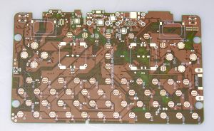

![](/wiki/images/thumb/d/da/Pyra_PCB_baredev.jpg/300px-Pyra_PCB_baredev.jpg)

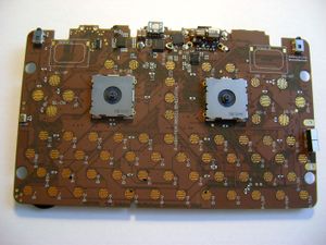

![](/wiki/images/thumb/5/53/Pyra_PCB_keyboardside.jpeg/300px-Pyra_PCB_keyboardside.jpeg)
