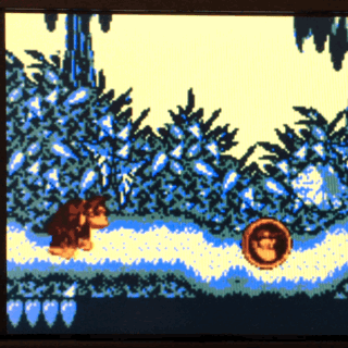

i have the whole suite of .emu emulators on my pandora and they all work fantastically EXCEPT GBC.emu, which has a weird screen tearing issue. I've tweaked every setting but it still does it. The tear is vertical and in the right half of the screen consistently.
I tried gambatte as well and it did the same thing which I found REALLY weird.
Gngb (I think it's called) is the most recently updated GBC emulator and it DIDN'T do it, but it's also nowhere near as polished to use (I really prefer the .emu ones). It's so weird that this doesn't happen on SNES or GBA, which are significantly more demanding.
Help? :(

As a reference, I've tried to upload a gif off my iPhone (let's see if this works!)

Well, the GameBoy runs at an especially weird refresh rate (59,7Hz) which no LCD does support... so it's not easy getting it tearing free (Well, running at 60Hz would be an easy way, but then it would run a tiny bit too fast)
