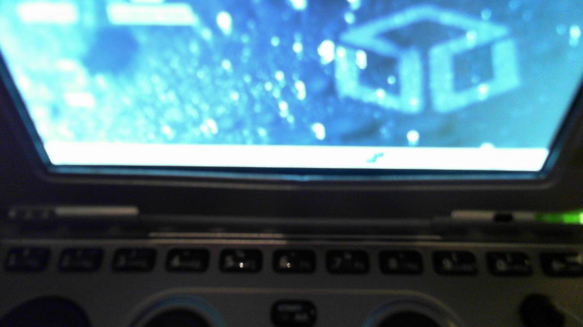

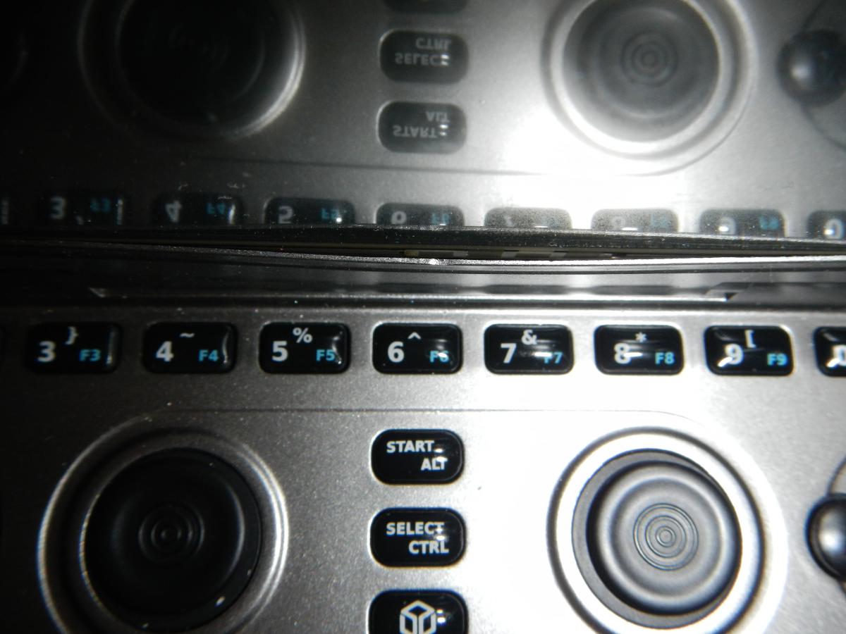

I've also attached a photo of a bulge at the bottom of the LCD. I don't know if it is related or even an issue, but it might be useful.

The calibration you showed looks fine.  Mine have the same problem as you but works fine in games.  My guess is that you have to apply perfect pressure at all times while dragging for it to work but that's hard to do because I drink too much and my hands are always shaken :)   Have you tried a game with it?  If it works with a game, I wouldn't worry about what you showed in the video.  The bulge on the bottom shouldn't be an issue because mine is the same like that.

The bowing on the bottom of the screen is typical to the Pandora, an unfortunate design flaw and all three of my Pandoras have it... however your issue is most likely the clips on the top of the screen. ensure they are popped in place.

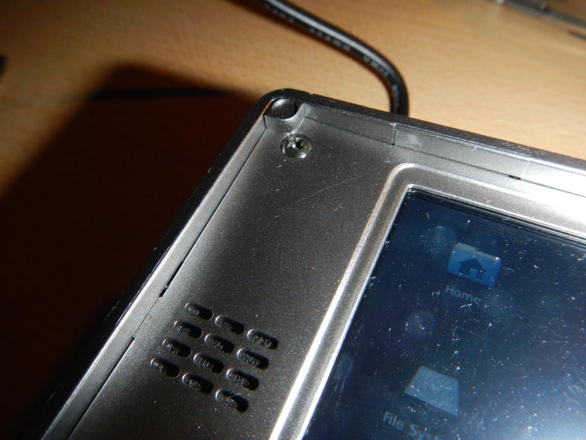

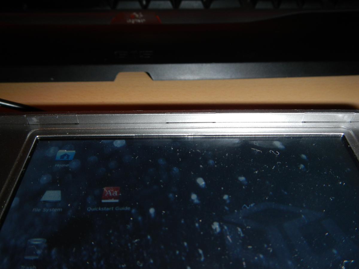

I have just checked and the clips seem to be in place. The top corners (at the screws) of the bezel seem to stick out a bit, but I'm not sure if its supposed to be like that. The screws in those corners are properly tightened and both corners look perfectly symmetrical compared to each other.
EDIT: I loosened the top two screws and tried using the stylus progressively until they came off, sadly to no avail. I recalibrated again with the screws loose, but also no effect.

^ There's no snapping there.  Yes, don't be afraid to gently press it down as there's a piece of adhesive there to glue the screen to the bezel.  But I think yours is missing this piece of adhesive that's probably why the two (bezel and screen) are not sticking together.  I doubt very much this cause the issue (the separating of the bezel and the screen) that you have.....
That picture of the top left of the screen looks different to mine.  Granted, you've unscrewed the screw quite a way which might be why that corner seems higher.  There's a slight upward lick on mine in both top corners, but it's not as pronounced.
Also, I wouldn't expect to see that much of the side lug visible, so it may be that it's not clipped in there properly.

Pressing down indeed didn't solve the issue. I'm glad to know however that the bulging bezel at the bottom isn't an issue. I think i'll leave it that way for now.
There's indeed a small upward lick, but it is very slight. I've applied some pressure to the side lugs, but they seem to be clipped in there and they won't budge.
