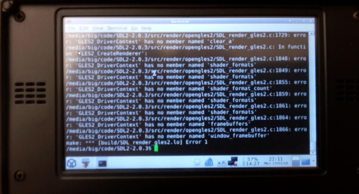

    After porting a rather big sdl project to sdl2 and the raspberry,
    fully through ssh / nano / gdb / etc, I thought " WHAT THE HELL , let's get the pandora out and get some use out of it "  B)
    but using the CDevtools and trying to build SDL2 at the root of my sd after
    ./autogen.sh
    ./configure
    make
    I get no member named on 'GLES2_DriverContext', ( attached screen , can't ssh here to the pando to cut paste )
    which make me wonder if the gles stuff is in the pnd?
    actually, greping through /usr in the pnd, I could find no definition of this object .
    Any idea?
    Anybody interested in SDL2.0.3 around here ?
    Thanks for your time !
    edit: the struct that has pb is in SDL2 src , which is weird.
    since I could build the exact same archive on raspberry, probably something is in the platform specific .h ?
    Taking any advice here , including RTFM .

    I just have build SDL2.0.3 using cdevtools. There were three offending lines I have modified:
    src/libm/math_private.h:29:// typedef unsigned int u_int32_t;
    src/render/opengles2/SDL_gles2funcs.h:70:// SDL_PROC(GLint, glGetAttribLocation, (GLuint, const GLchar *))
    src/test/SDL_test_fuzzer.c:41:#define __USE_ISOC99 // added line
    I don't have any SDL2 programs at hand to check if it actually works.

    I strongly suggest you use ptitSeb's patch, regardless of what PND you pick. But generally speaking, if you want to use newer libraries you'd better use codeblocks. Cdevtools is really more firmware-based, good to build kernel and modules.
