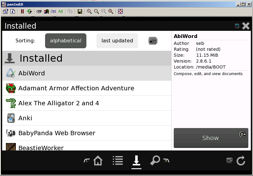

The upgrade all function is available from the 'Installed' screen. After a successful sync all upgradeable PNDs are listed at the top with a button to upgrade them all.
Maybe I am a blockhead, but... I don't see that button!
This is my "Installed" screen, and I have done a sync using the "sync" button in the lower right corner:
I'd suggest you try changing the loggingVerbosity setting in appdata/pndmanager/settings.cfg to 3 and then try scanning that card again. Hopefully then the pndrun.out file will be more useful. :)
That suggests that all your PNDs are already up to date. (or have a different unique id to the version in the repo) If there are no updates available the section doesn't show up. Are you sure you have any PNDs that aren't up to date?
No, I think all my PNDs are up-to-date. At least I updated them a few days ago using PNDStore.
So that explains it. :)
May I suggest that you add an indicator to the "Installed" screen, which lets the user know, that all his installed PNDs are already up-to-date? Preferablly just in the same place where otherwise the button for "Update all packages" (or however it is labeled - I have never seen it yet) is located.
