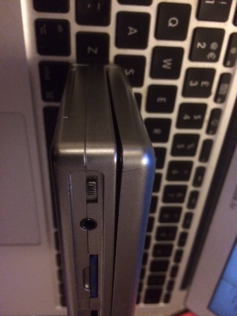

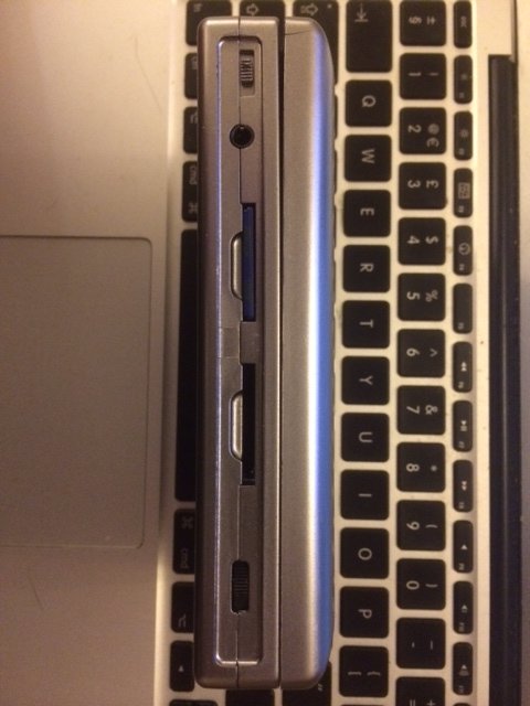

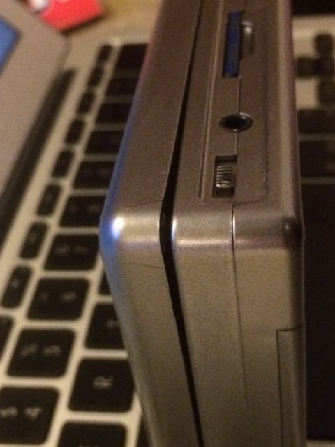

After a very short time with my Pandora, I was upset to see small cracks forming in the corner of the lid. :-((
I wondered how I'd managed to do this as its been ether in use or in its case in my coat pocket (only 3 times so far).
When I looked closer, I saw that the lid doesn't meet the body properly on one side, a closer inspection and I saw that the whole body was actually curved, not the lid.
Is there anything I can do about this to stop it getting any worse. My guess is that any pressure on the part of the lid that's not meeting the body when its in its case in a pocket or being held is bad news.

Hmm, now you mention it there is a slight curve to the case on mine too. The lid doesn't meet on the left corner - that's a standard feature, and I always thought it was to do with the hinge mechanism, but maybe the curve of the base has something to do with it too (or more likely, if the hinge was straight, the lid wouldn't meet at the right side either).
I don't know about these cracks in the lid though. That's odd. Is the lid inner clipped in properly and not stressing the lip? Still, those cracks look mostly cosmetic to me - even if that corner fell off it wouldn't stop the Pandora working, although you might consider that to be unacceptable cosmetic damage to be fair. If you're not worried about the looks of it now, and if you can rule out stress caused by incorrect assembly, I suggest it's something you'll have to live with.

heh... mine looks like that too, including the crack... In my case, I put rubber protectors on the lid (these round things at the corners). I thought mine curved because of that.
My screen lid is exactly like yours in pic one. Flush on the right, but not on the left. It's normal.

Do you actually have a black or silver case? Little difficult to see in the picture.
I guess (almost) everybody (including me) got a Pandora which lid does not close entirely on both sides, because of the already mentioned low quality cases. I never saw this as problem.
The black cases had some serious material problems in the past, leading to cracks in a lot of Pandoras (including mine). They switched to the silver cases because they are of higher quality, although i don't know whether the crack problem was solved completely by that. When the cracks are gettig more, you should contact ED to get replacement.
I personally liked the black one more, and my replacement case I got from ED does a very good job until now.

well this is "normal"
the iner part of the screen lid was designed to fit exactly... before the painting process kicks-in. So the pain thinkness account a lot in this bending.
