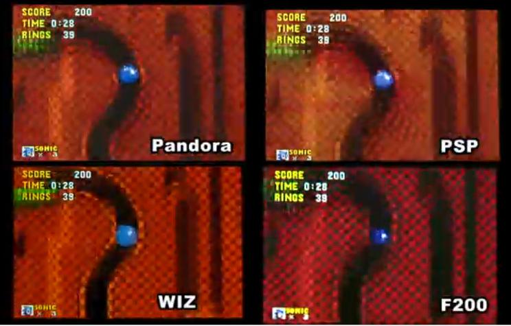

I tried to compare the WIZ, PSP, F200 and Pandora-Display in regards of ghosting. As suspected, that can't be really done. The camera used was doing HD (720 with 50p) and the game usually runs at 60Hz which is way different.
You can see a BIT of a difference though. First you see the game in fullspeed and after that at 50% speed which makes the ghosting more visible.
As expected, ALL LCD have ghosting. In my opinion, the WIZ one (a OLED) is the best one regarding to ghosting (no surprise here). On second place if you only take a look at the ghosting is F200 and Pandora. However, F200 has weird colors and contrast (I tried to fix it with a color correction, but the colorspace seems weird here). Therefore, I like the Pandora one better.
While the PSP one basically has the same amount of ghosting, there is one thing that makes it look worse (can also be seen here in the video): The ghosting is very dark and therefore clearly visible.
The Pandora / F200 has a much lighter ghosting which makes it look like a motion blur (and that does make the games look similar as on 80s/90s CRTs) , whereas the PSP does look like it smears.
Both the Pandora one and WIZ one look sharper than the others. No surprise for the Pandora here, as its normal resolution is much higher (800x480).
So, which is the best LCD? It depends on what you want to do
The WIZ one is looking good but lores and small (and OLED still has some issues).
The Pandora one is nice with some ghosting visible, but actually looks like some motion blur.
Same for the F200, except for those scanlines and the bad colors / contrast.
The PSP one is bleeding colors, as is already known for a long time.
Laurencevde said:AFAIK, OLED shouldn't have any ghosting at all. So, either the WIZ has a really bad oled-screen, or all the ghosting on the WIZ comes from the camera-setup...
I think you're going to need the burst-mode of a decent camera...
wermy said:EvilDragon: Which version of PSP are you using?
EvilDragon said:wermy said:EvilDragon: Which version of PSP are you using?
PSP1000 Got it with an 1.5 kernel to hack it
EvilDragon said:You need a camera which is synchronized to the screen, which isn't easily possible.
As said, I was recording with 50p (50 Frames Progressive) and Sonic should run with 60i (60 Frames interlaced, however, interlaced doesn't work with LCDs so it was probably 30p).
Laurencevde said:Oh, and Exophase, I really hope European consoles were running at 50Hz...
