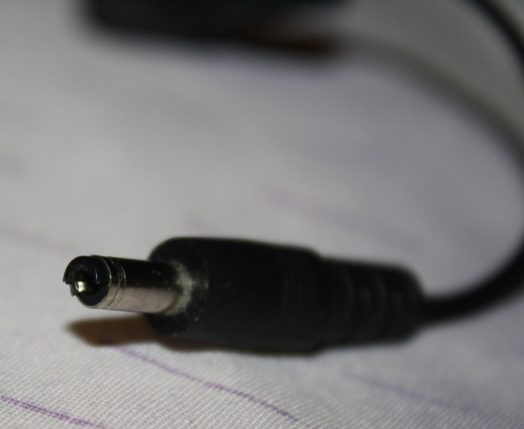

The barrel jack adapter included with one of my Pandora chargers broke. (Part of the plastic ring at the end of the barrel plug on the adapter cable broke off. It still works, but it fits loosely.)
Can anyone tell me the dimensions of the connectors so I can eBay up a replacement? I wasn't able to get any PandoraWiki search results.
(While I'm at it, I'll also probably buy a replacement for the still-working one that came with my second adapter. I prefer not to have a rigid adapter acting as a lever and placing unnecessary torque on the Pandora's charging port.)

4mm Ø
1.7mm inside
and 9.5mm long
Actually, I was hoping for the dimensions of both ends of the adapter. Would these be the right size?

For anyone else who finds themself in my situation, the answer is yes. I just received the two adapters I ordered from that eBay results list and they fit and work perfectly.
